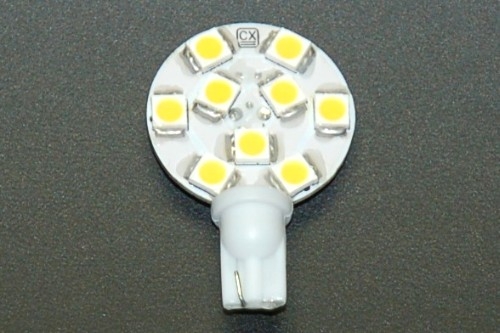

Marwayne/Outbound,  what's the nomenclature for the round 9 LED you are using? I'm trying to locate it online to measure its output in lumens. Thanks, Bill

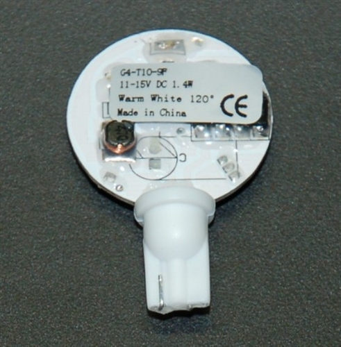

Technical specs:
  • LEDs: 9 Triple Chip SMD LEDs
  • Base: T10 Wedge
  • Size: 29 X 6 mm
  • Light Spread: 120 degree
  • Wattage: 1.4 watts
  • Voltage: 11-15V DC
  • Lumens: 140 lumens
  • CRI: 80 - 85
  • Colour Options: Warm White 3000K, Cool White 6000K
  • Replaces: 15W Halogen
  • Warranty: 2-year replacement
  • Environmental: No Mercury, Lead Free, UV Free

Actually, mine have 12 x 5050 SMDs
Color: 2850k
Voltage: 11-15 V DC
Wattage: 2 watts
Lumens: 220

@Outbound and @Marwayne
Do the ones you all have.  I'm just calling them pancake style cause they are flat like that.  Do you all feel that they dissipate heat well enough or that they don't get too hot?
I've read that they don't do a great job of dissipating heat and so I was looking at the type that is a rounded cylinder type on a ceramic base.
