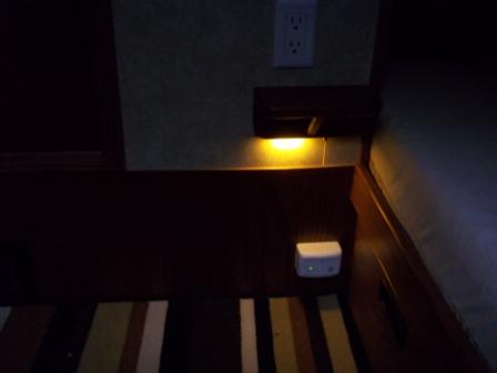

As for a nightlight I used a strip with 3 LEDs and build it in under my step to get into the top bunk. Powercons. 0.2 watts

I love that night light!

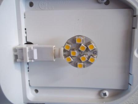

LED bulbs I used ( 1.7 watts)
Striplight 1.2 watts per foot (18 LEDs per foot) Marker lights 0.2 watts |
