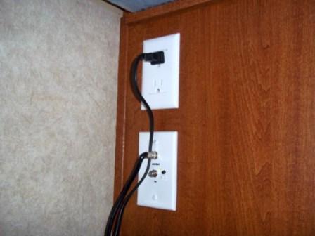

P&M, make sure the preamp is turned on, there is a small green led light that shows its on, if not you will get poor to no reception. On our 172 its in the cabinet above the stove.

There is a preamp? Where is it in the 177?

It is in the box that the TV is mounted to. Open the door and you will see it with the antenna cables coming to and from it. It has an led that is also a push on/push off switch.

Found it! Could explain why the tv didn't pull in any channels,,,not that we really cared to watch. Thank you!

A pre-amp button? And it isn't on the unit itself, but somewhere near the plug? Don't recall seeing one but will write this down in my log book so that I can look for it the next time I swing by the storage lot. That would definitely explain why I wasn't getting any channels ... thanks!

The amp switch is in the cabinet above the cooktop in the 172, I tkink it is the same in the 171.
bhamster ![]() Senior Member ![]() Joined: 19 May 2011 Location: Washington Online Status: Offline Posts: 165 |
Yeah, it's the same in the 171. It's also worth mentioning that the amplifier has 12V power, which makes it super-easy to put in one of these instead http://www.amazon.com/Winegard-RV-7042-White-Plate-Supply/dp/B000GGL4CG and get an extra 12v outlet.
Another note on it using 12 volts, if you are bookdocking make sure you turn it off when not in use.
