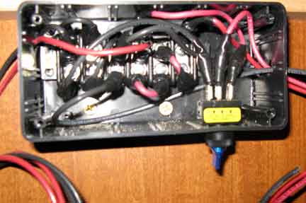

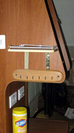

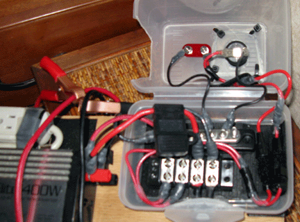

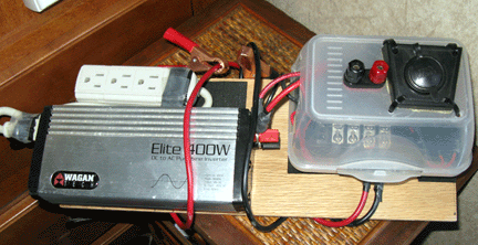

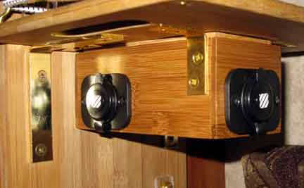

Hi Again,  Thanks for all the information guys. I'm just going to go out there and wing it. Finally loaded some pictures into the computer. Hope they loaded.
