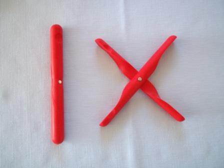

I also found these handy trivets, they are small and they are good for 260 C or 500 F
