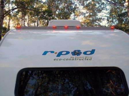

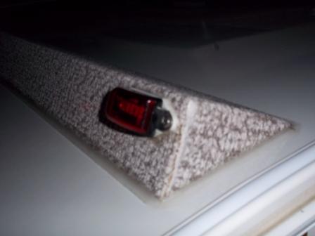

I can only speek for the172. I tied the wire in to the drivers side tailight ran it through the outside storage comp. under the seat than under the fridge up behind the fridge and microwave through the cabinet above the microwave, then drilled a1/4" hole through the roof.
Then build a spoiler out of plywood covered with decking material wired the lights in to spoiler.
With 4 srewes I attached the spoiler to the roof. The screws go into the metal cross member, then caulk.

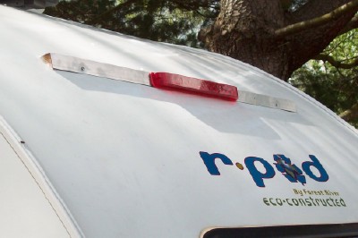

Just to tell you, I got a 4 ft long alluminum angle at Lowes, a 15 inche LED light at the camper place, made a foam gasket, drilled a few holes to mount the light to the angle, used butt clips with heat shrink covers over the wires calked into the angle and will try to find a couple of studs to screw the angle into with short stainless steel screws.  I will use a thin tape backed wire cover to get the wires to the cover that goes down the edge, than make a hole near the bottom (or maybe come right up the under floor) into the pass thru storage where I'll turn it over to my hubby to hook up the wires.  I think.  .... more to followErmm

Here it is!  The new brake light.  Turns out it is also an additional turn light.  I will feel MUCH safer driving now knowing others can better see when we slow down seeing as the factory brake lights are so pitifully low.
This is a Optronics 11 light LED 3 wire Streamline light. I got it at the camper store around $20.  Bought one 1/ 1/2 x 4ft. aluminum angle at Lowes.  The light is completely enclosed in plastic, so nothing to waterproof there.  I mounted it to the angle with stainless nuts and bolts, fished the wire thru to the back where I butt spliced and heat shrink wrapped the connections, than making one small hole all the way thru, fed the wires inside and covered in a neat little  tape backed track running over to the side and down into the storage compartment where my handy husband did the wiring.
The ends of the angle are closed with a neatly cut piece of cedar silicone calked in just so and a good bead of caulk along the top ONLY.  I left the bottom unsealed to act as a drain incase any water does get in.  It is held in by two stainless 1 inch screws, but mostly the caulk held it.  Not bad for a housewife, huh?
