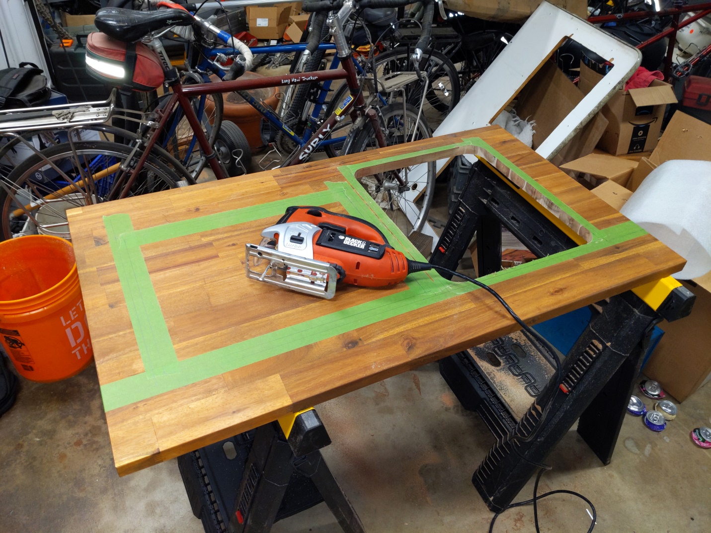

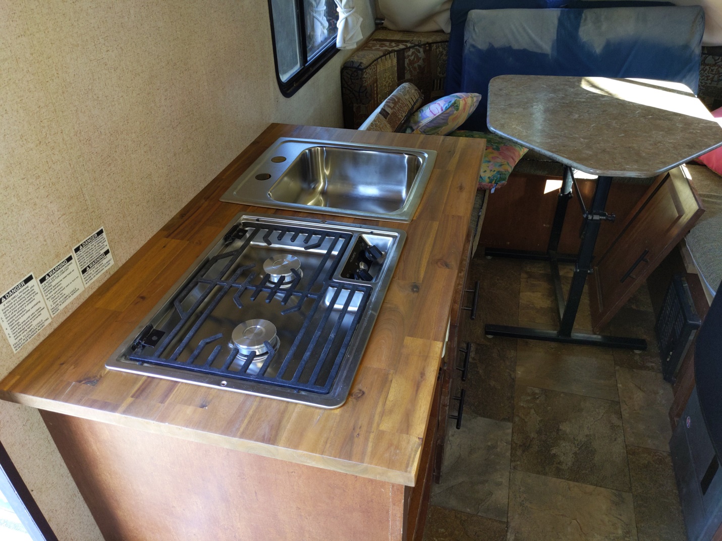

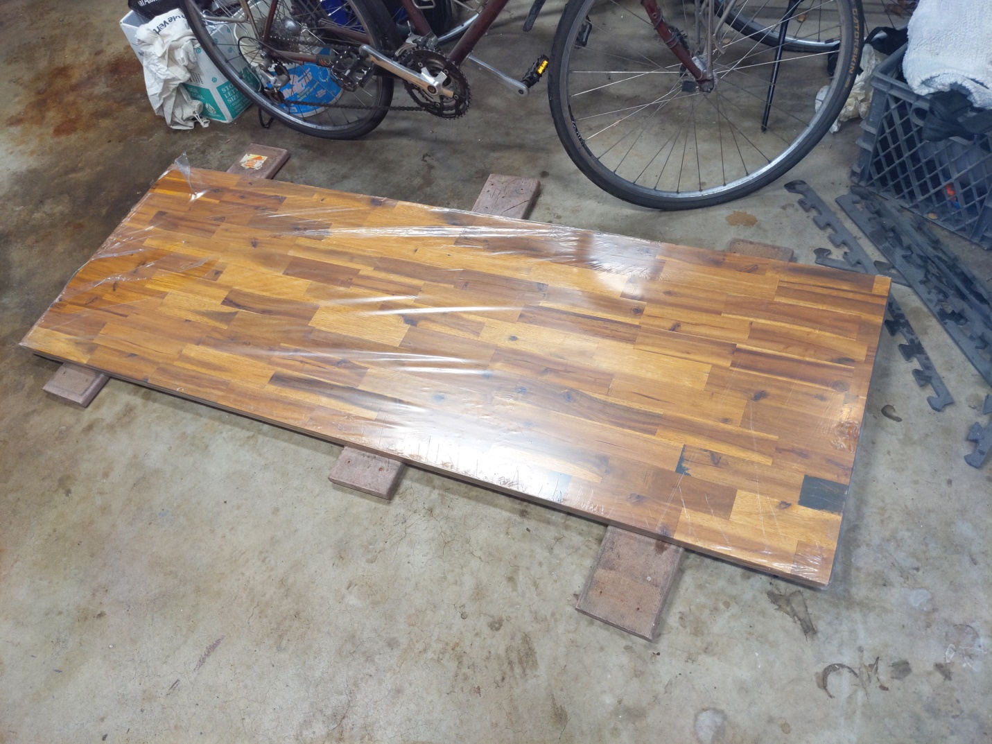

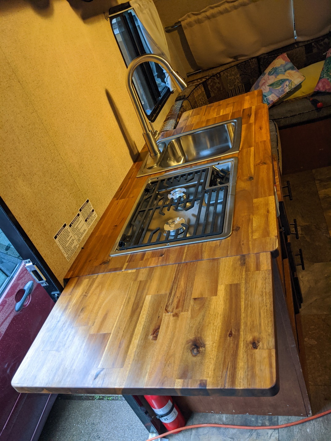

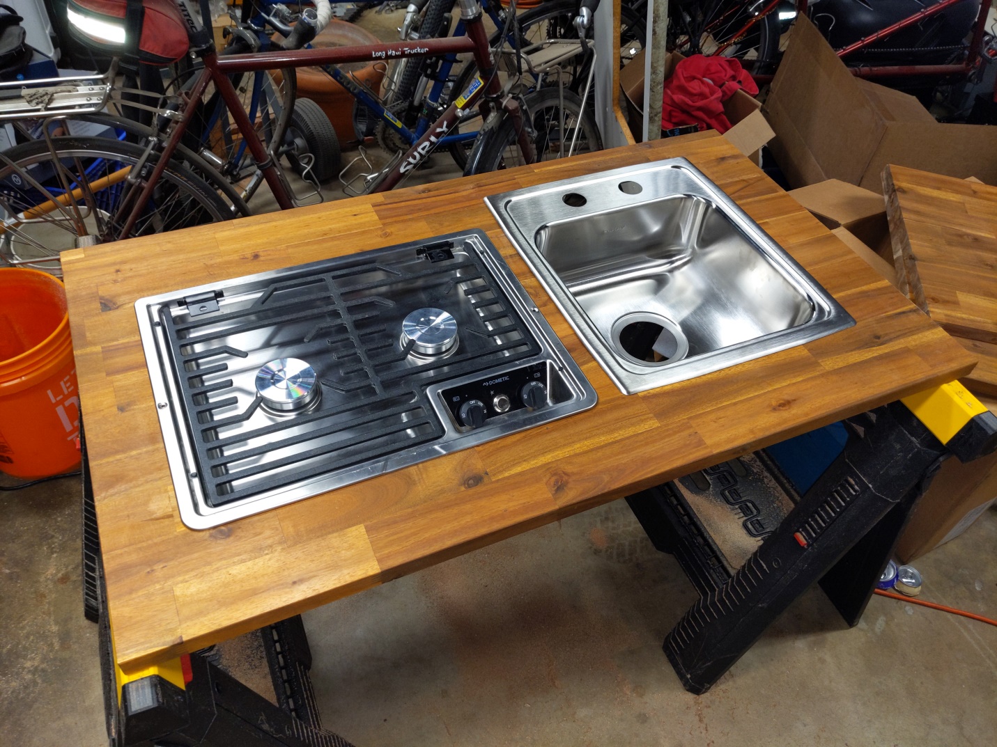

The first thing I decided to do was get rid of that awful laminate countertop and dinette table and replace it with something nice. I found this 1" x 25" x 72" butcherblock at Home Depot for $159 and bought two.
https://www.homedepot.com/p/Interbuild-6-ft-L-x-25-in-D-Acacia-Butcher-Block-Standard-Countertop-in-Golden-Teak-with-Square-Edge-675781/317198293

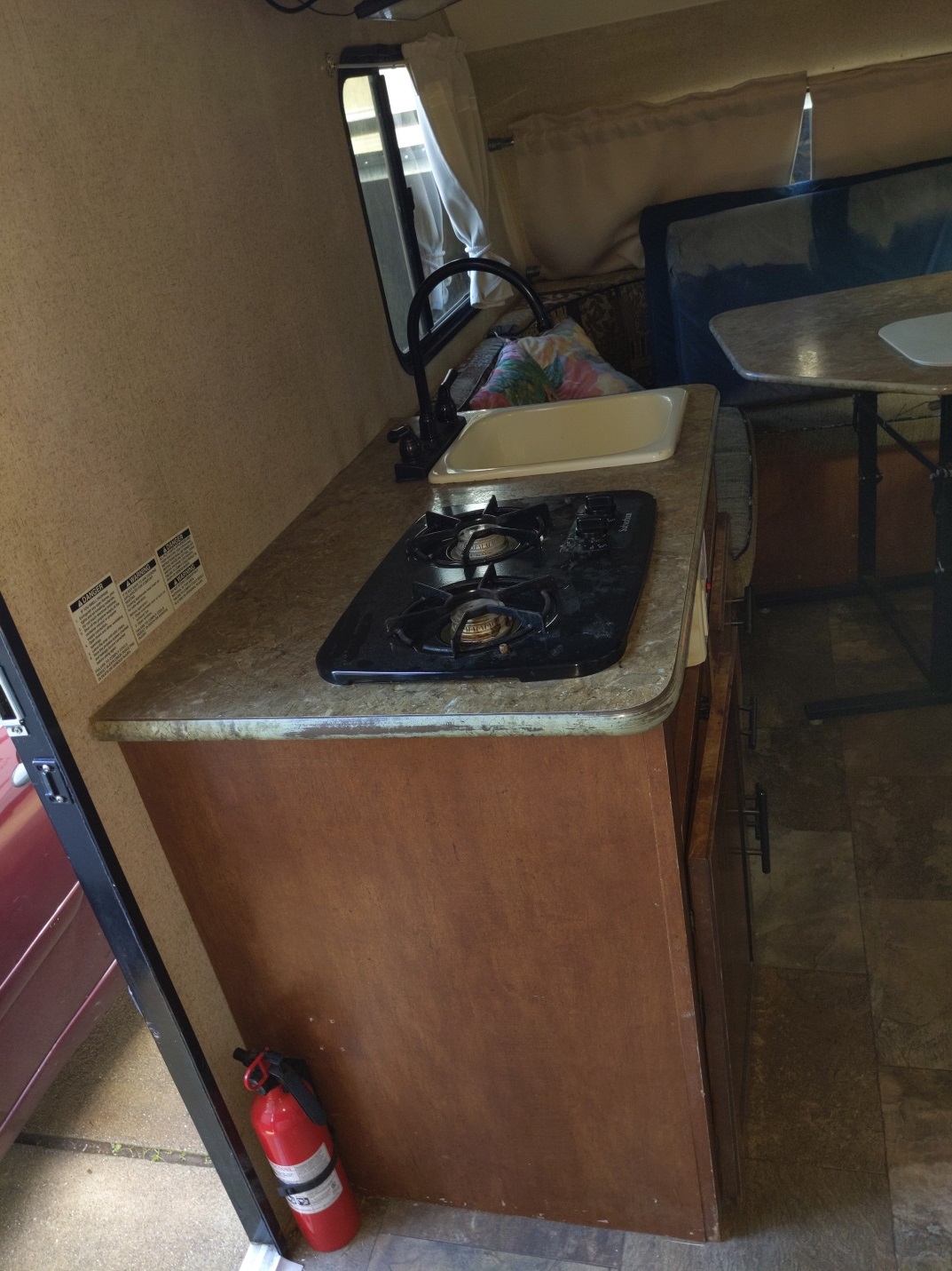

Here's a before and after.

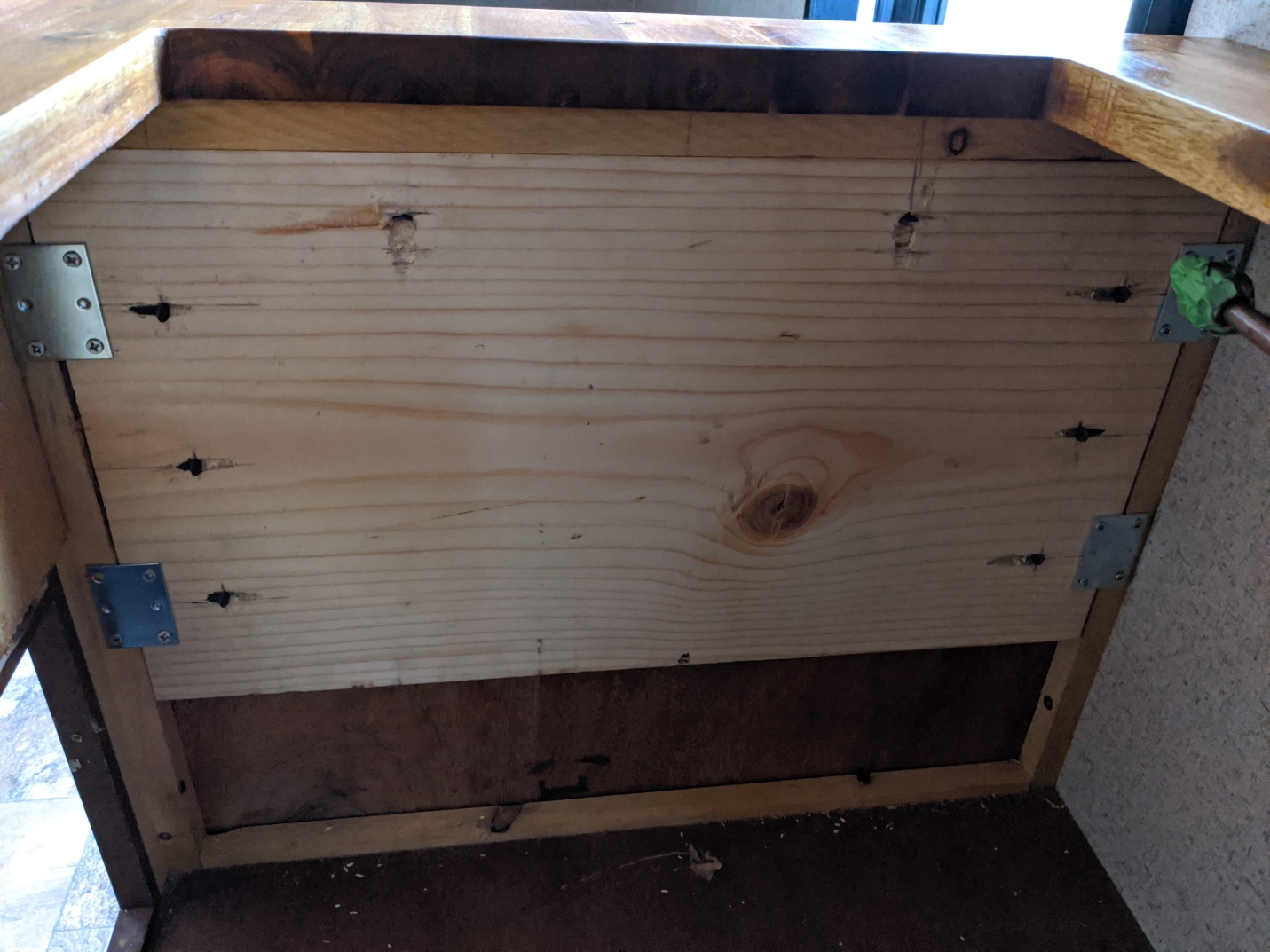

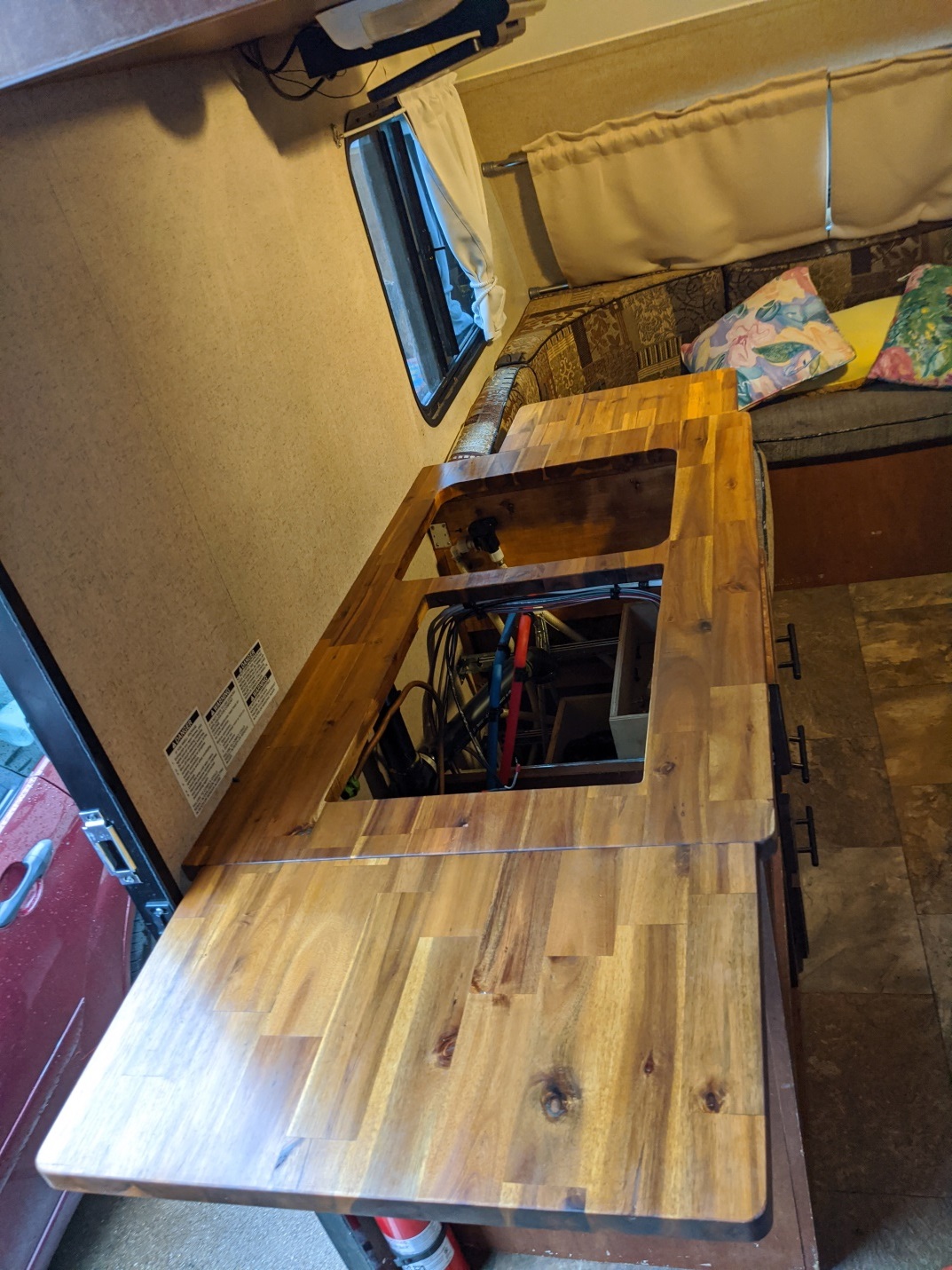

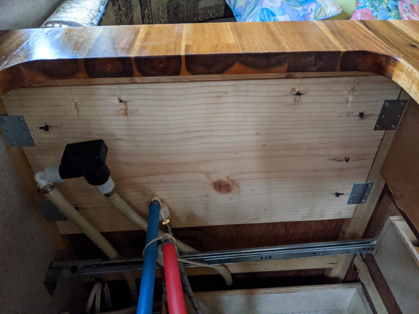

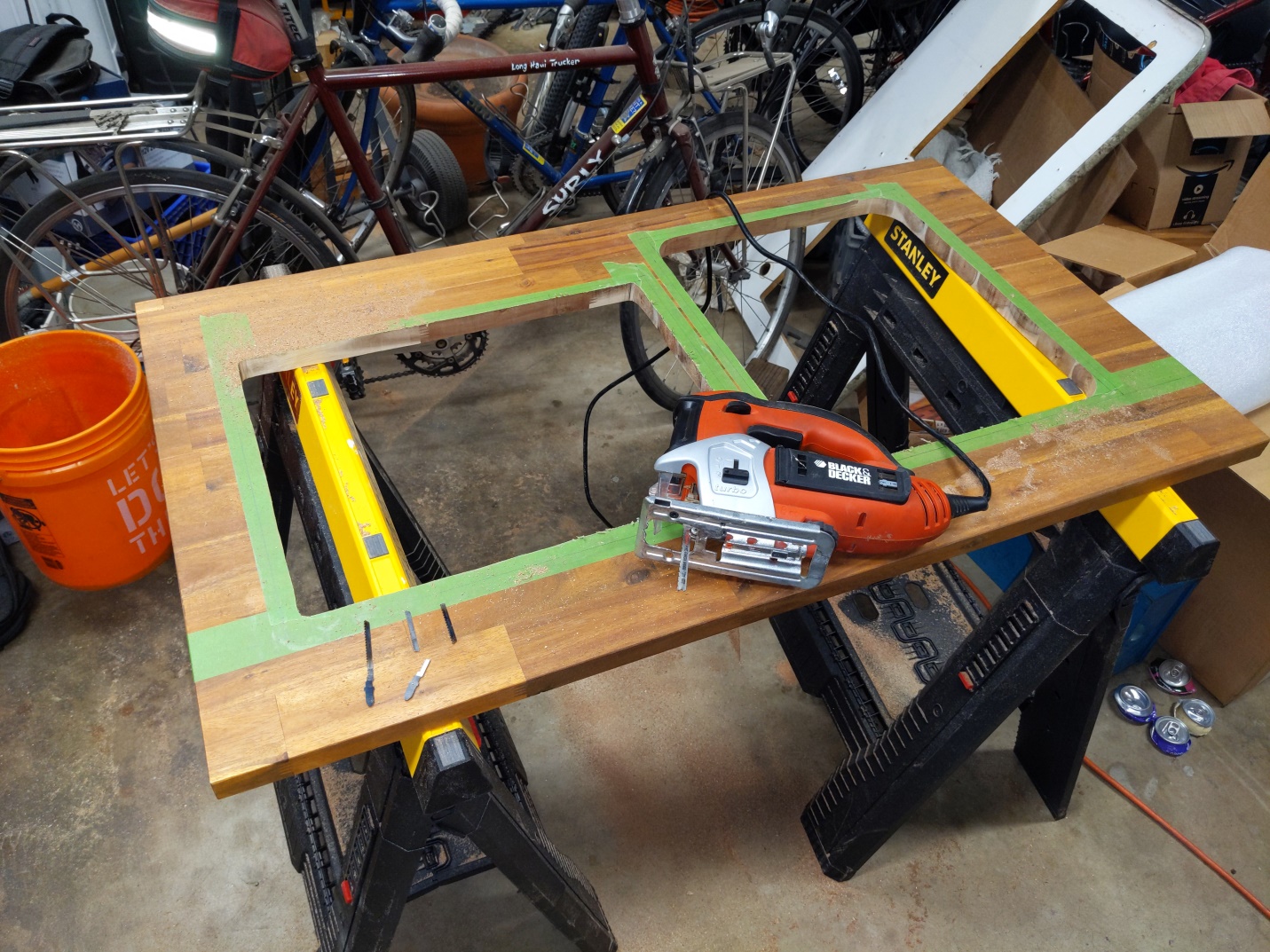

As you can see, I added some flip-up countertop on each side to make the kitchen much more user-friendly and a nice shiny SS sink and stovetop from ebay. Here are some pics of the build process. First I removed the old countertop and added some 1 x 12 pine boards to each side for mounting the flip-up countertops.
Continued on next post.

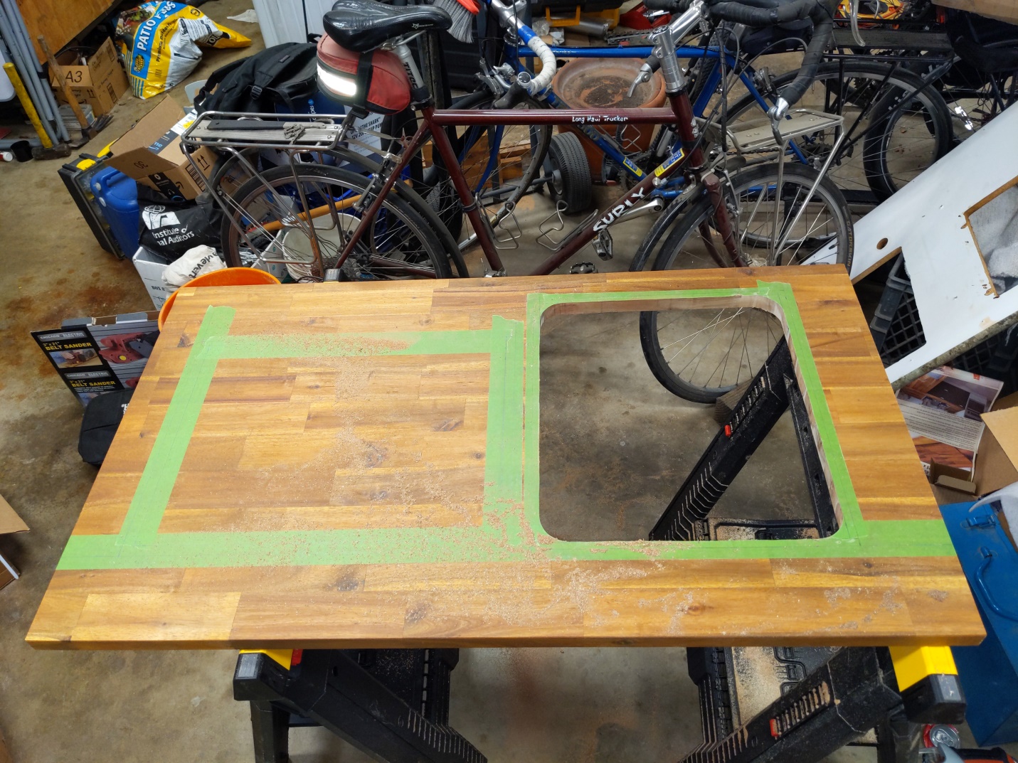

Here I am measuring twice and cutting once.
I rounded the corners of the flip-up counters using my router. I think it looks pretty good. It's a huge improvement over the stock countertop.

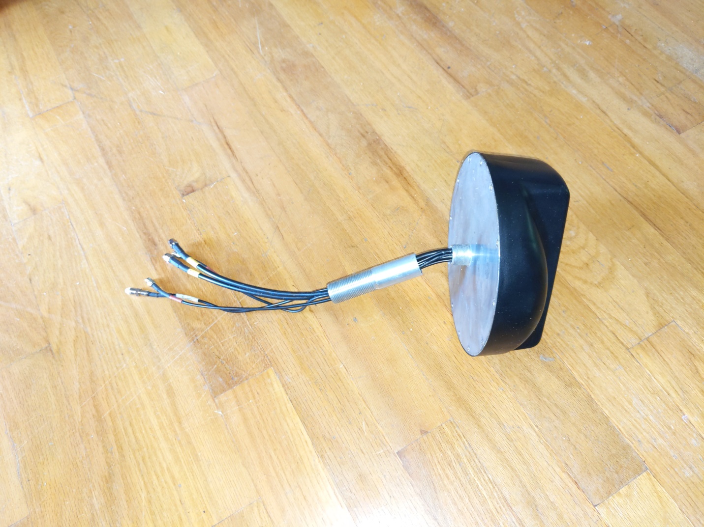

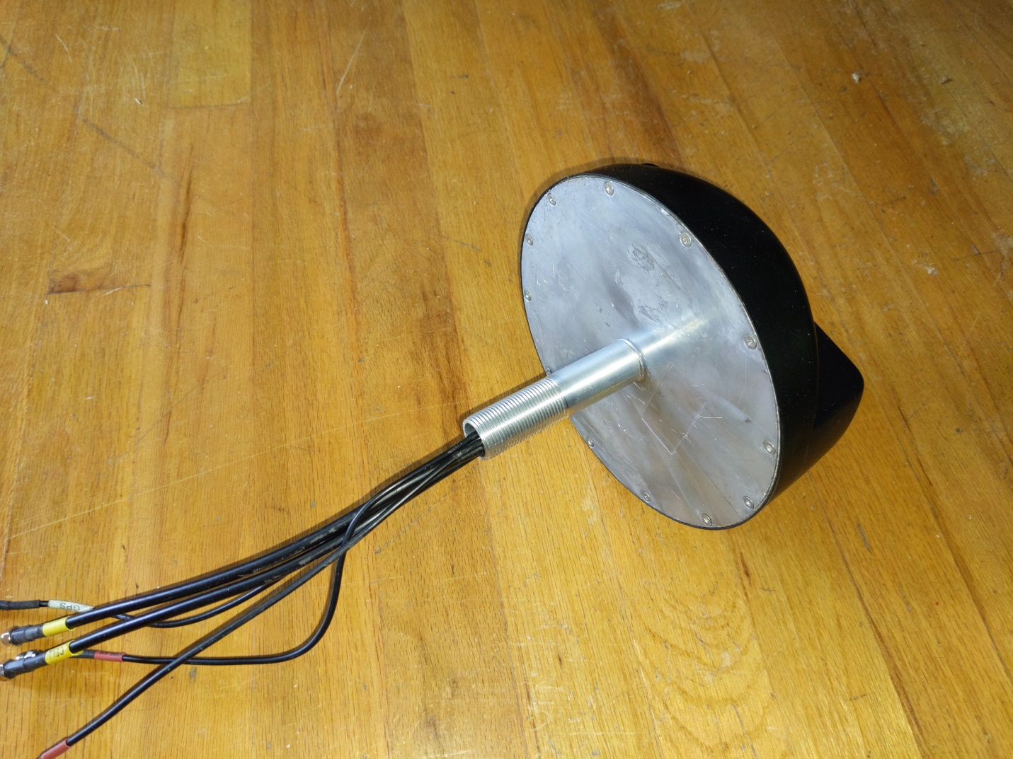

The TV antenna was very corroded and had started to leak water so I removed it and put in a Panorama combination Wifi/cellular/GPS antenna. We really don't watch TV but we do like our Internet. Because this antenna is made for thinner roofs and the extender offerred by the manufacturer still was not long enough, I had to fabricate my own 80mm mount extension. Here's some pics of it. It was not easy to make since it required some very fine and large metric taps and dies to fabricate. Let me know if you'd like me to make one for you. I have all the tools now.Smile

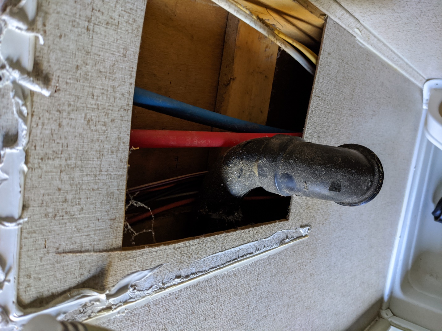

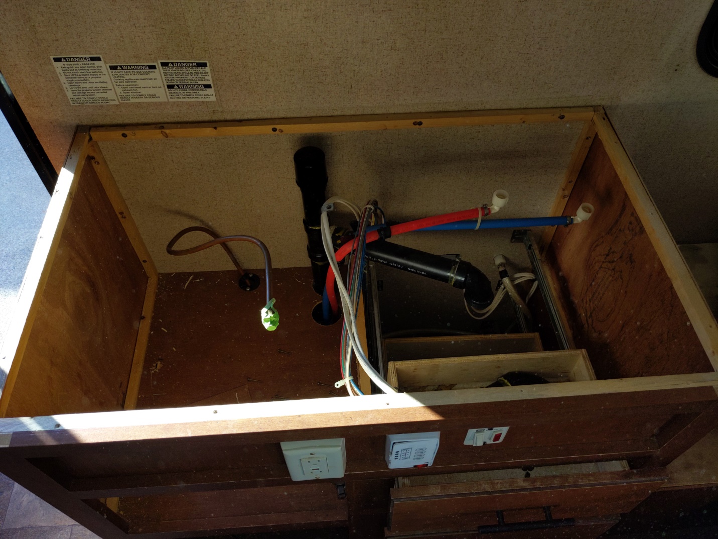

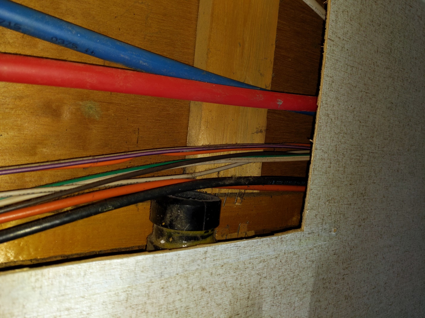

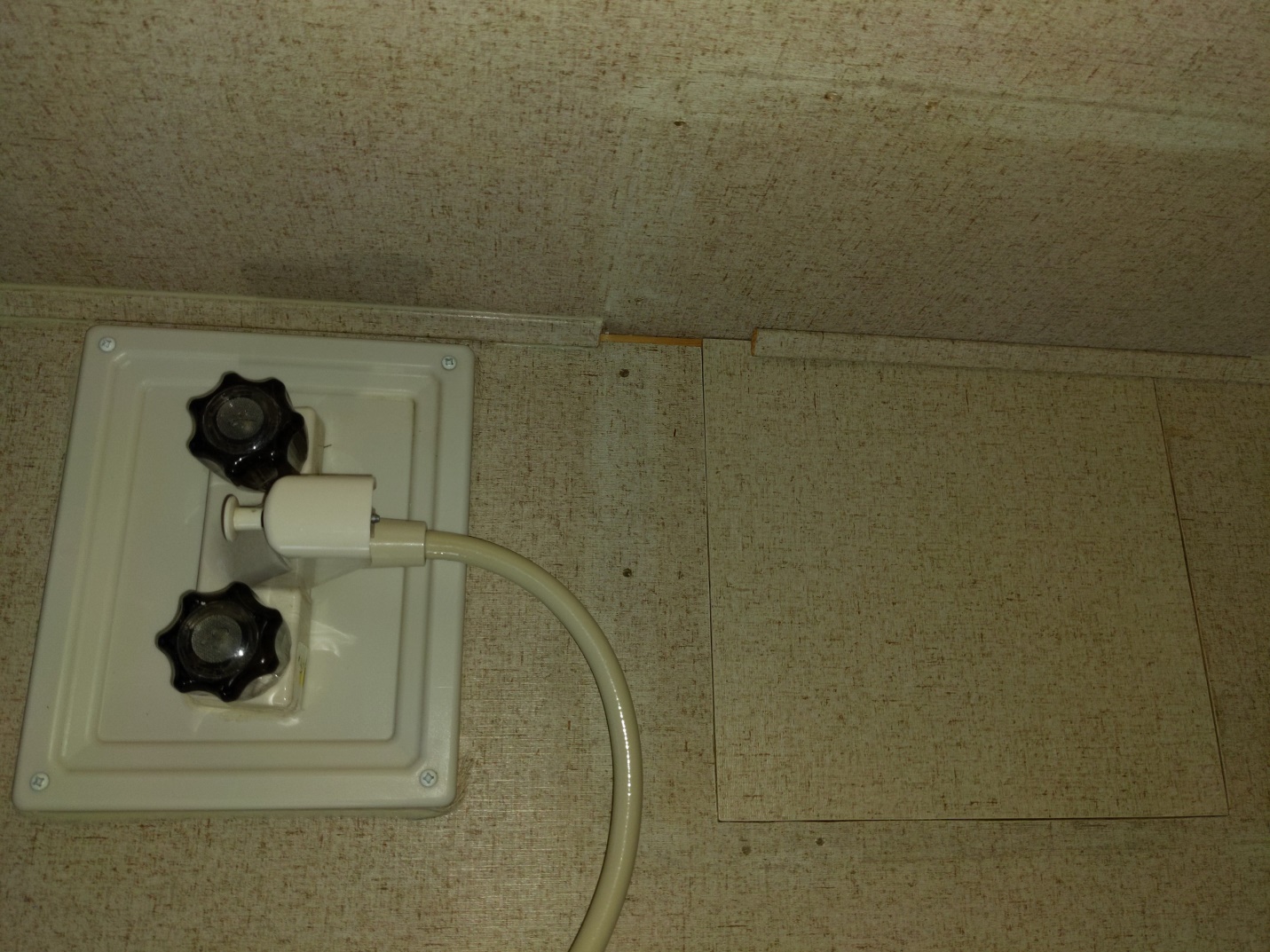

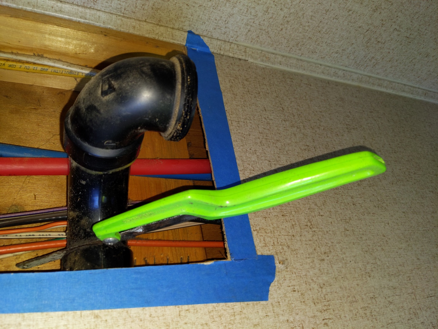

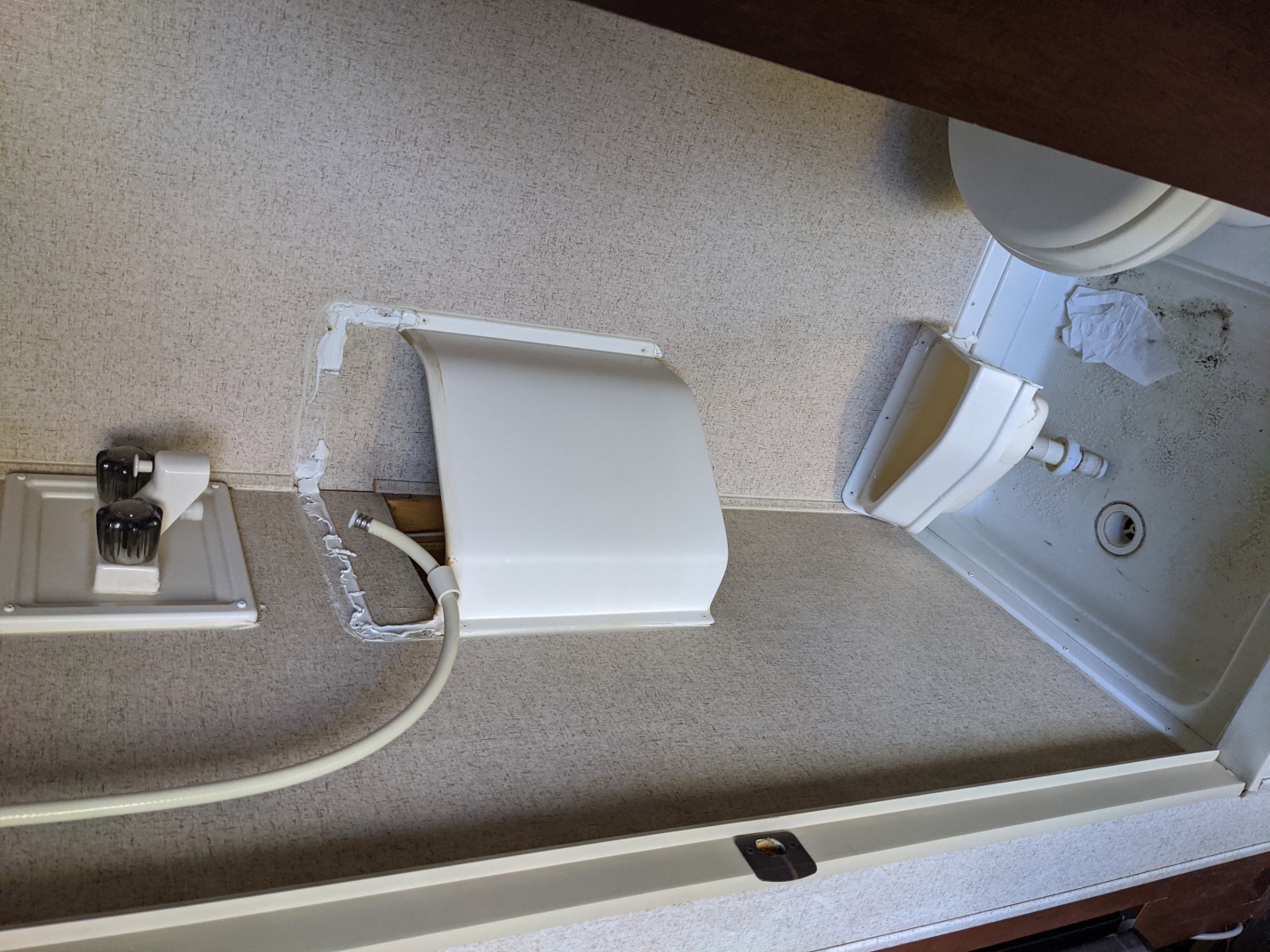

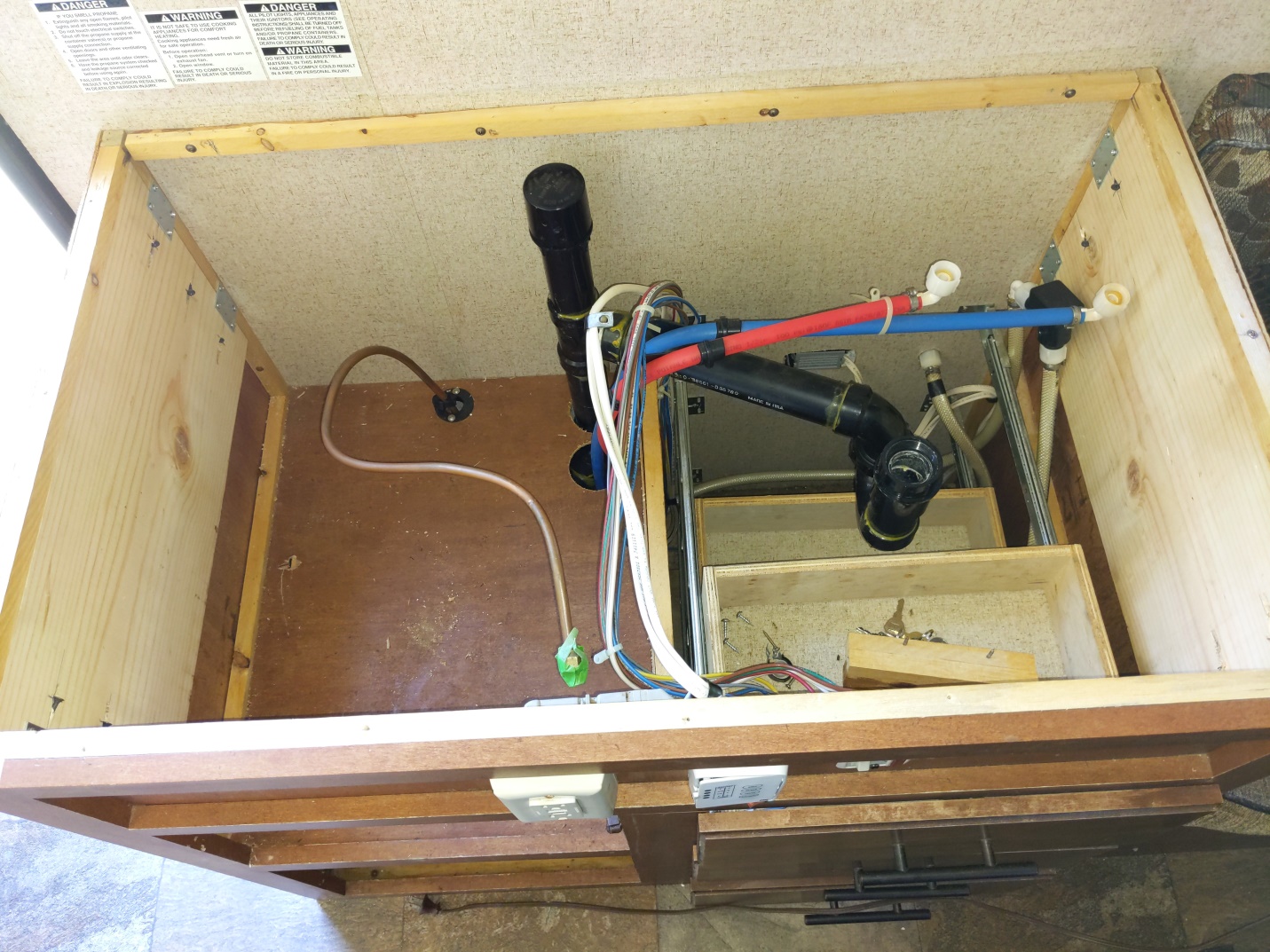

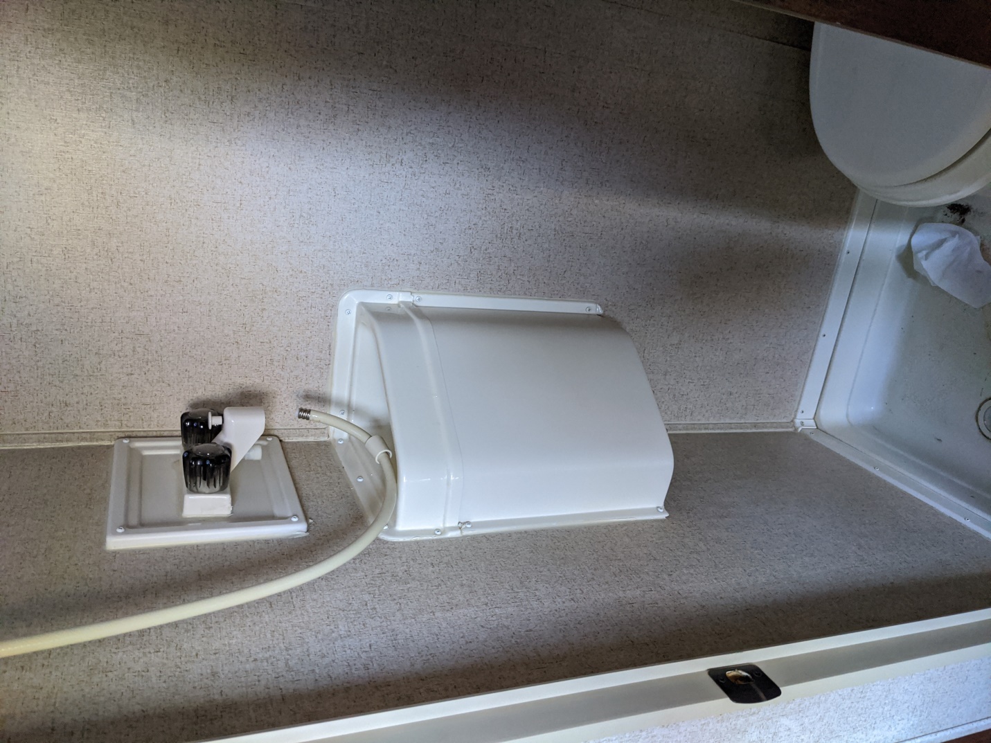

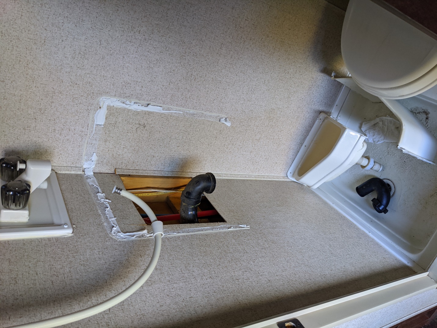

I also removed the bathroom sink as it was pretty useless and took up valuable space. I'm posting pics of the process in the hope that it will help others to do the same. I have seen others do this but with very few pictures that show the process.

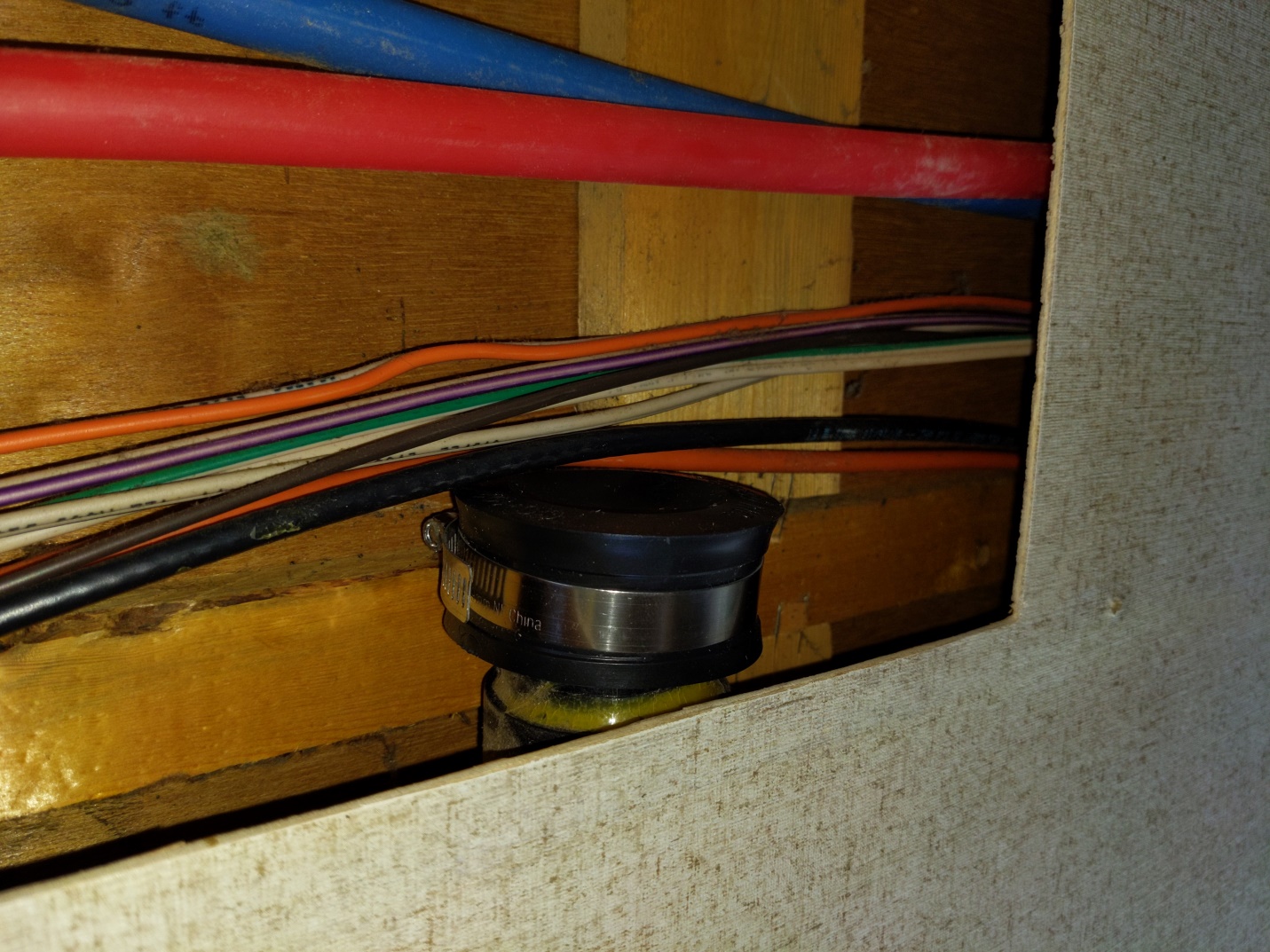

I had to cap off this drainpipe. I ended up cutting it right at the hub of the elbow and used a rubber cap to seal it.I had to widen the opening to get the saw in there.
Don't worry, I used a hose clamp to keep it in place. Big smile

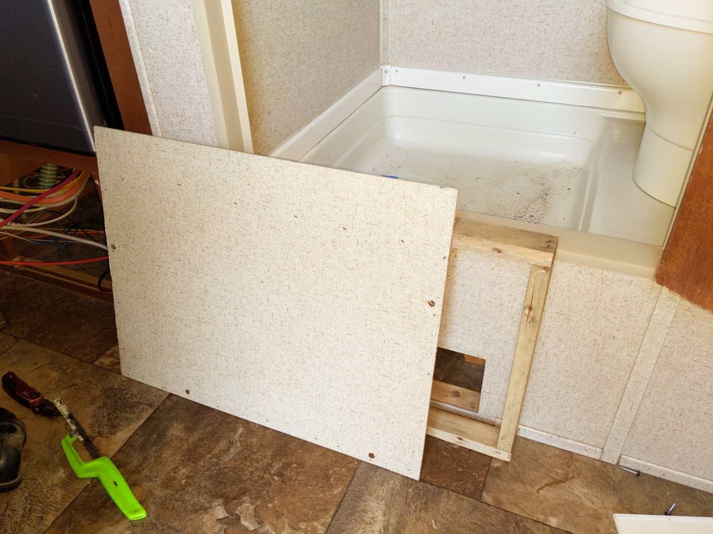

I found this matching piece of wall behind the broken refrigerator and carefully cut it to size since I did not have a second chance.
Here's the rubber cap with the hose clamp on it.

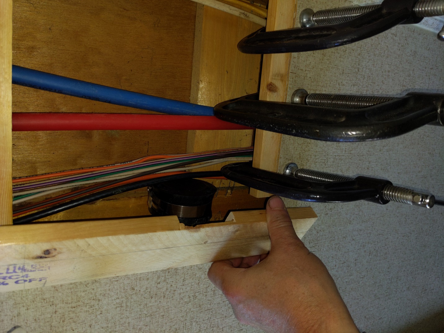

After squaring up the hole (a utility knife works really well on this thin stuff), I glued and clamped these pieces of 1 x 3 around the perimeter so that I could glue the new piece in there.
Here it is all glued into place. It doesn't match exactly, but it's good enough for me. I also need to put in some kind of corner molding since the one in there has a big gap.

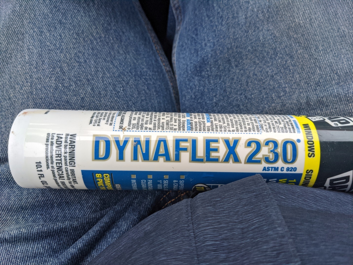

This is what I used to caulk it.

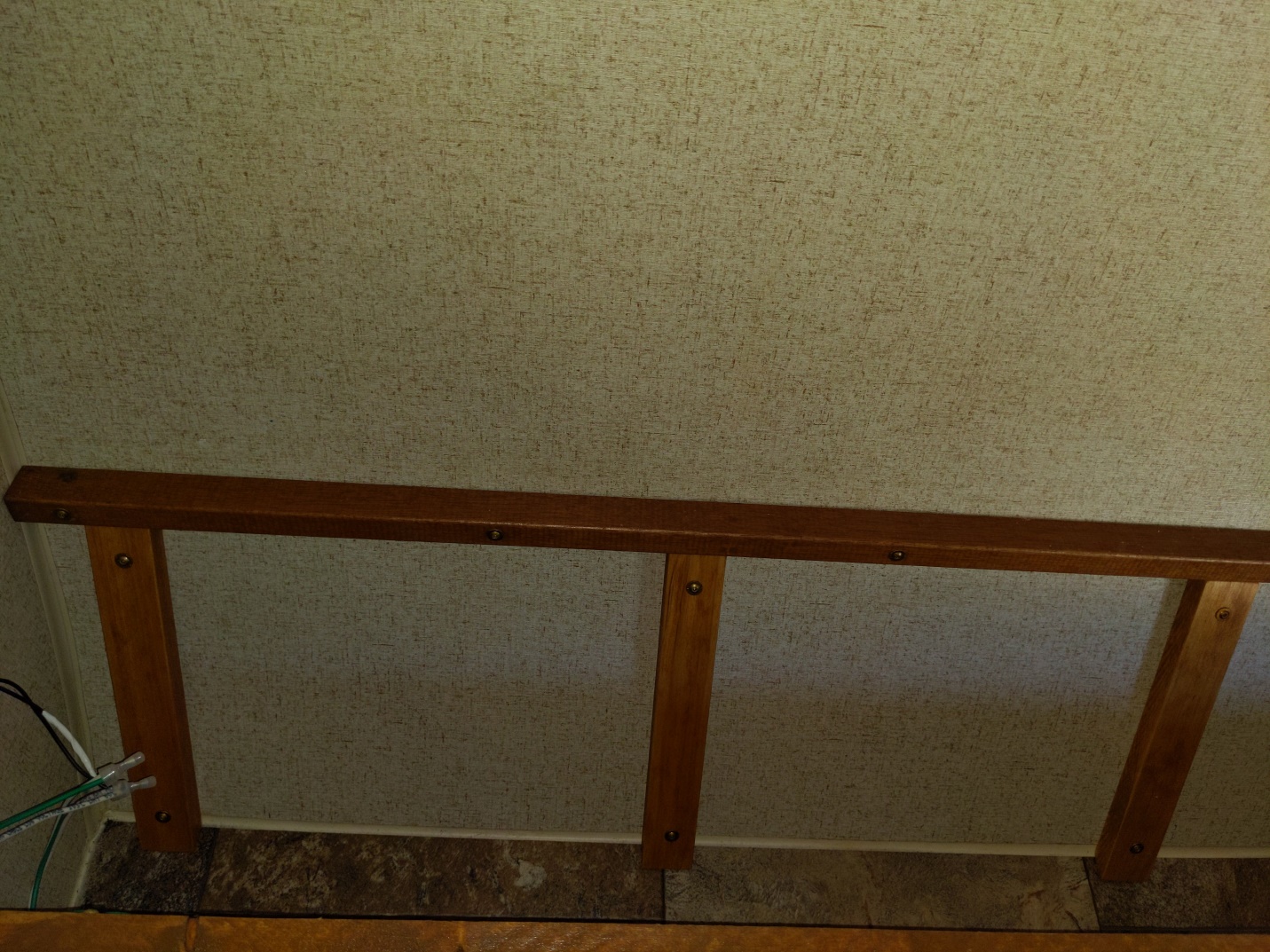

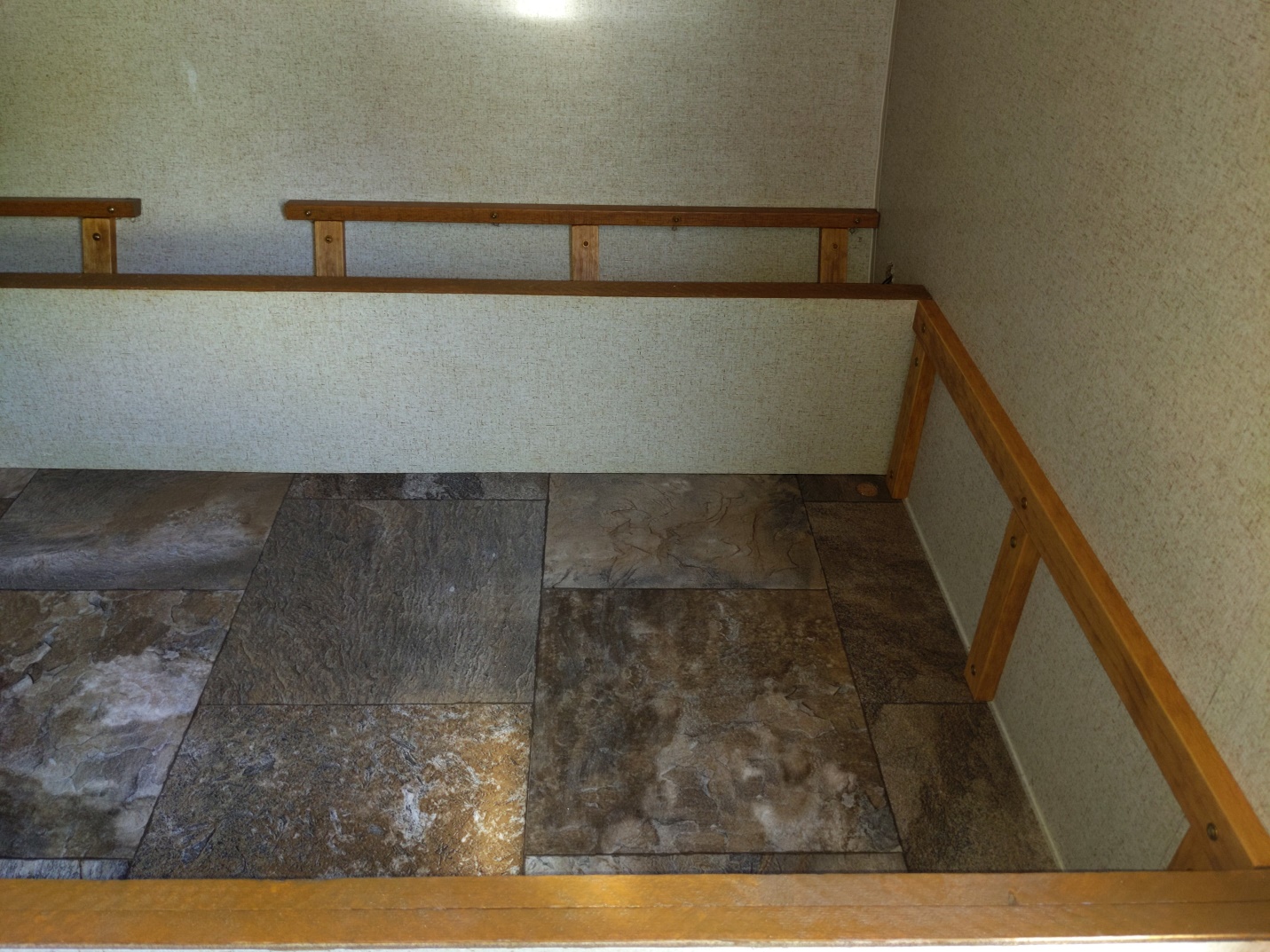

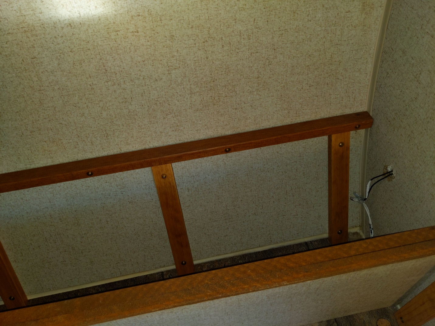

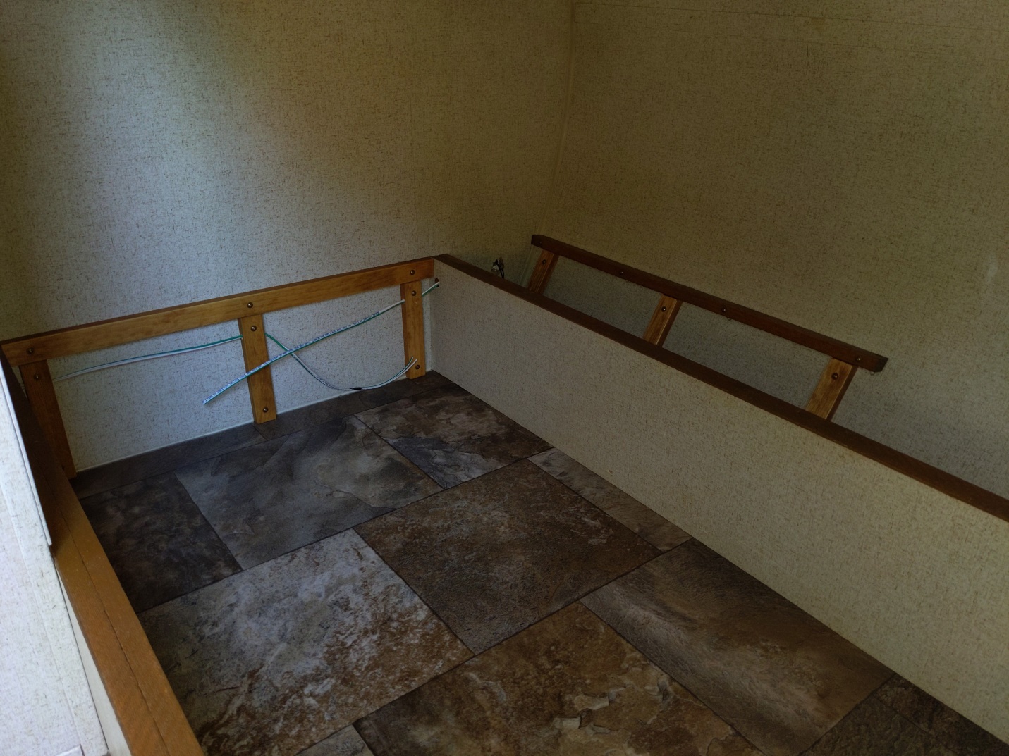

I also decided the lower bunk did not have adequate support. The side supports were pulling out of the walls! Here's my remedy. The front wall was tricky with the odd angles. I think I ended up doing 22 degree cuts if I remember correctly. A table saw came in very handy.

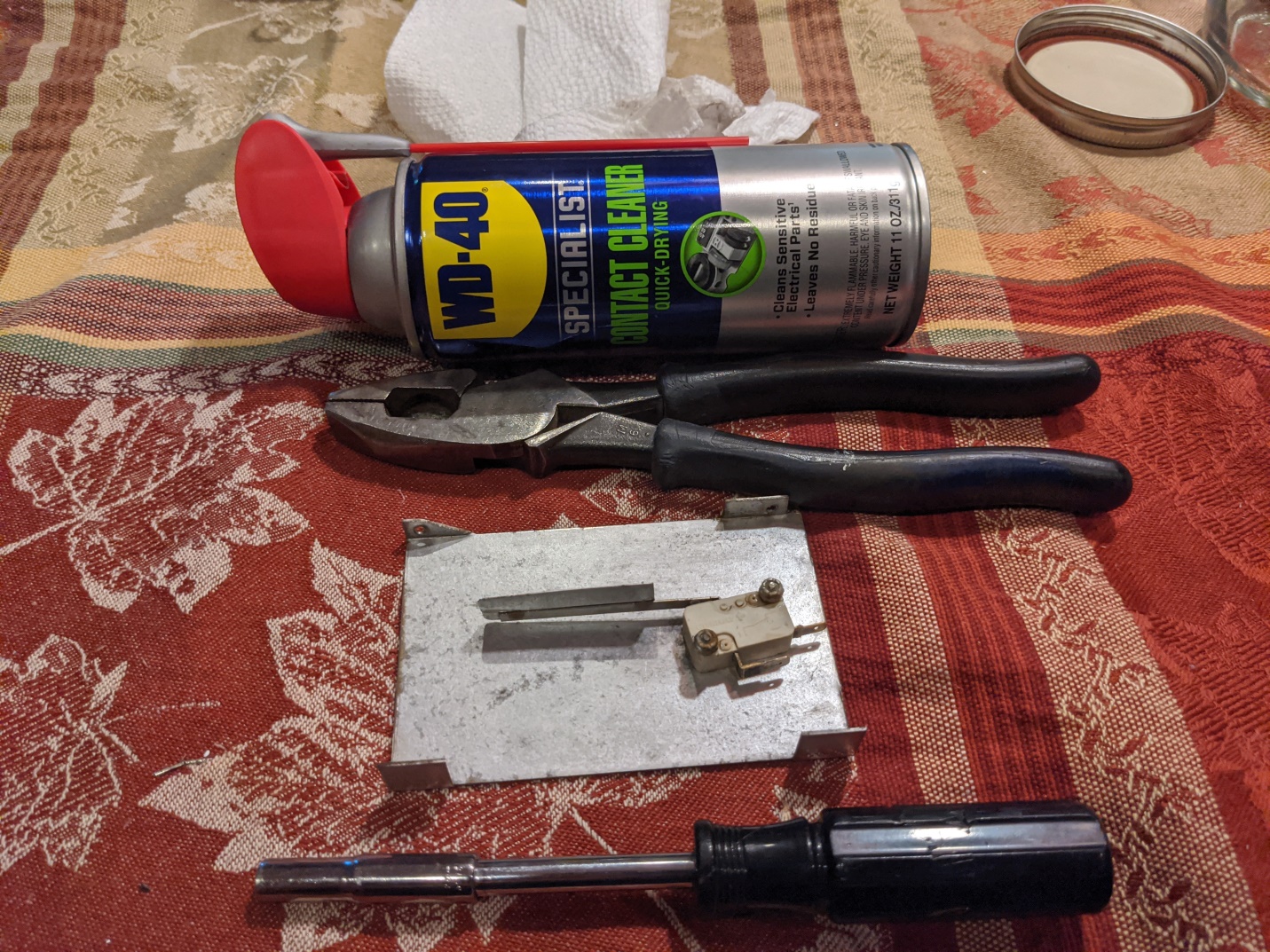

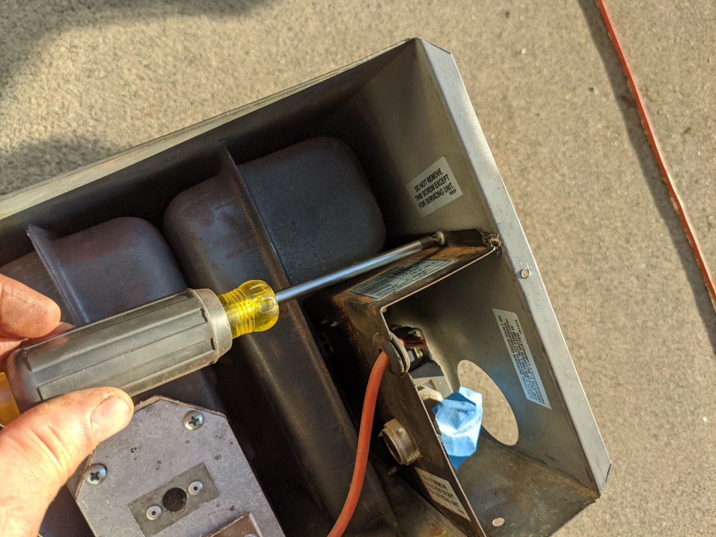

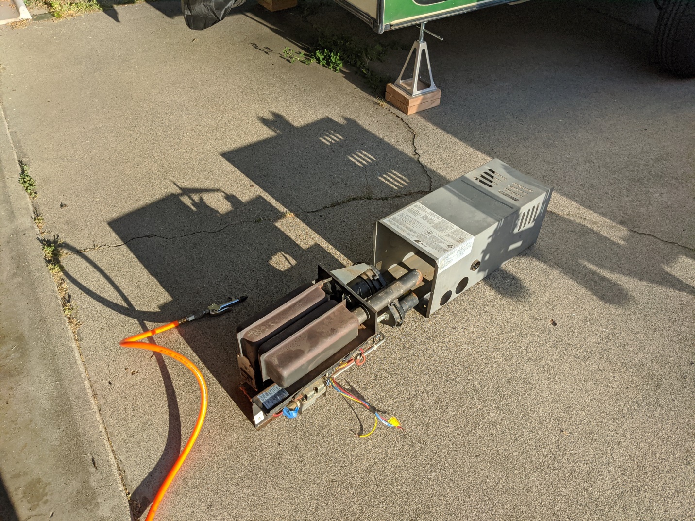

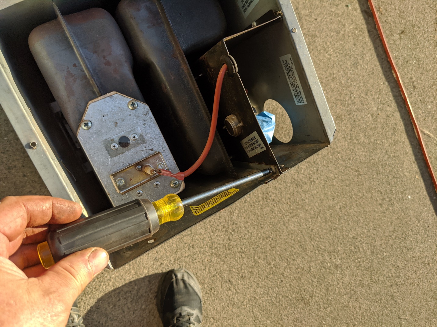

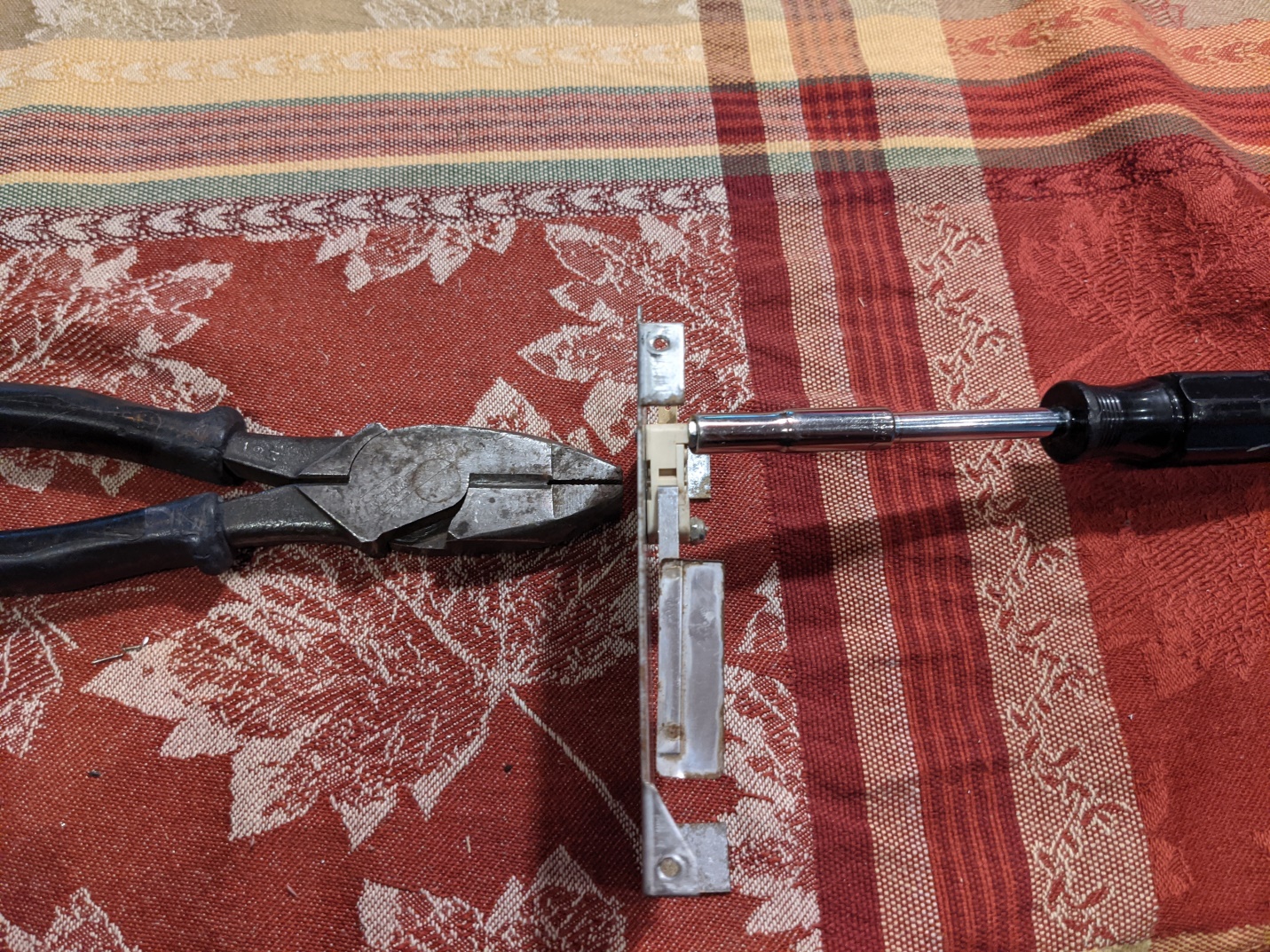

The heater was not working so I took it apart and cleaned the sail switch. Now it works.  Here are pics showing the two screws that need to be removed to take the outer shell off.
And then it slides apart like this. I used compressed air to get ride of most of the dust.
Here are pics of the sail switch and how I cleaned the switch and its contacts with contact cleaner.
There were some tiny screw heads that I had to use my linesman pliers to remove.
The water heater gas  worked but the electric did not. I replaced the disintegrating anode, flushed the tank, cleaned up and painted the outside of the water heater, and replaced the bad electric heating element.

Some very nicely done projects on your 172.  The counter for the stove and sink is really nice.  It looks like you took out the bunkbed and replaced it with an expanded lower berth.  We did the that in our 172 and kept part of the upper bunk between the head and the front wall as a shelf.
