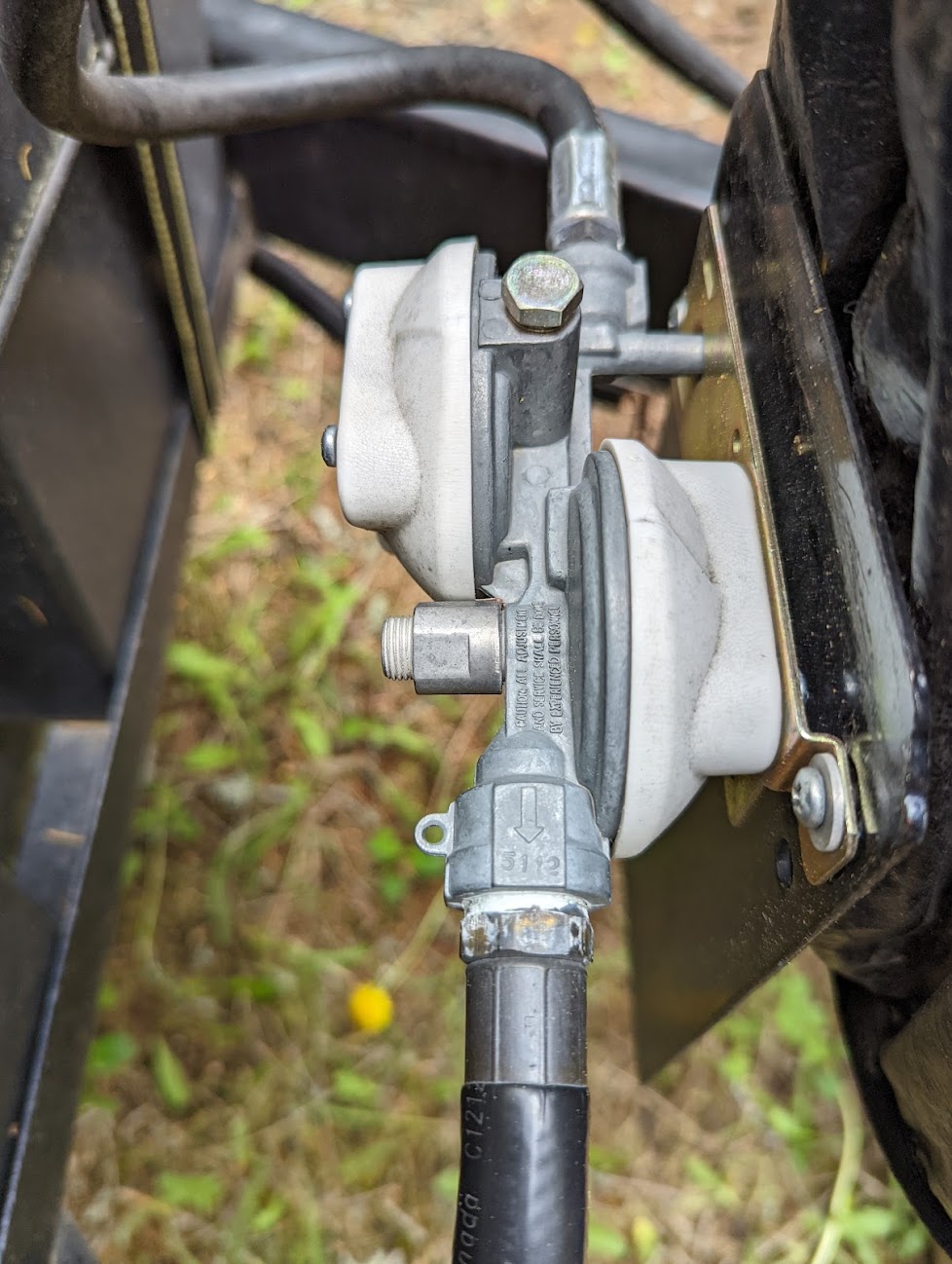

Okay, that is not a dual propane regulator. It is a dual-stage propane regulator. It is horizontal so that the vents are on the bottom. We had one like that before I changed to a dual-tank setup. There are many sources available for regulators as mentioned in posts above. When you get a replacement, but sure to mount it so the vents are on the bottom.

I'm looking to replace a leaking dual propane regulator, however really having a hard time finding one.
It's on 2014 RP178.
Thanks for your help !
