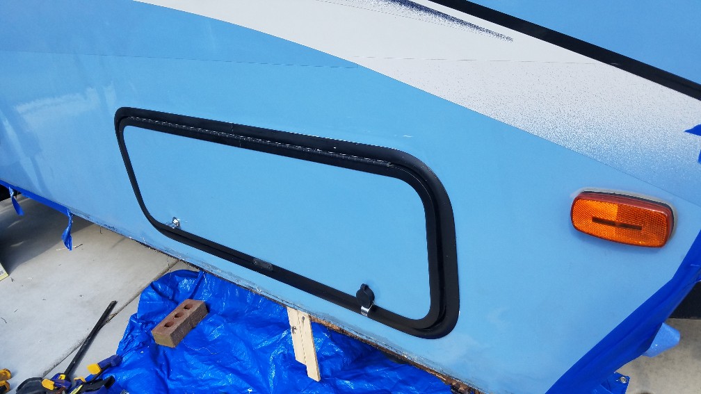

Not perfect but much better than before.  Now I need to go along the bottom and fix the rest of the issues.  This is a slow process but I feel like I am making headway.

Not sure if everyone is interested in my exploits with this repair but I do believe if you own an rPOD with similar construction delamination is going to occur eventually.  This may not be a perfect repair but I believe it will hold up for several years if the trailer is maintained.  What I am seeing on the front and lower area is just poor workmanship on the part of Forrest River.

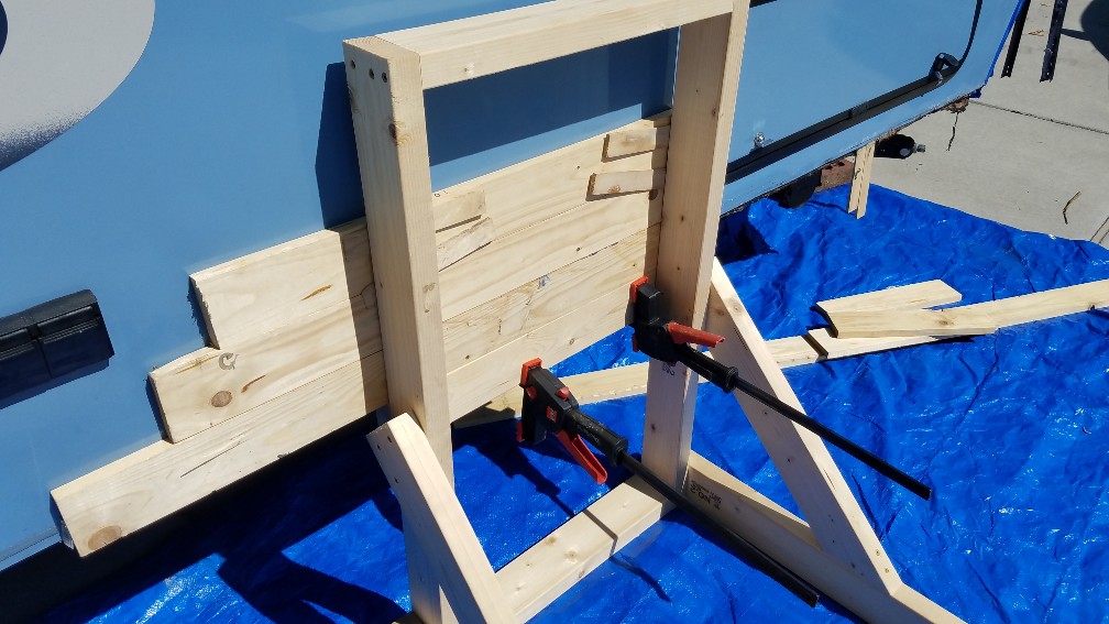

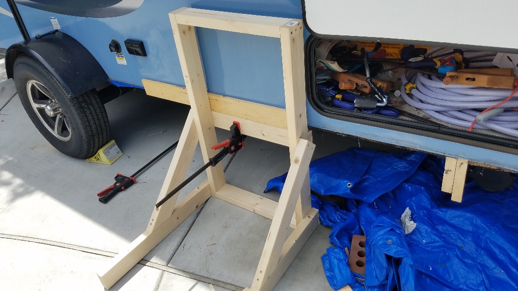

No it's not some medieval torture device....I had to build a frame work that allows me to use the trailer chassis and a clamp to pull the clamp boards in tight.  It doesn't require a lot of tension to pull the delam in but the flatter you can get it the better.

Here is my contraption in action.  The 2 clamps go under to the trailer frame and pull it in tight.  I use wooden wedges (used in door framing) to tighten up the upper board.  As I said it doesn't take a lot of tension to get everything in place
Another note that may be of help.  I had a lot of sealer along bottom edge to remove and without a doubt the best tool is your fingernail.  I carefully scraped with a plastic putty knife and laquer thinner but when you want to avoid scratching the fingernail can't be beat.
Also no sanding required for this operation just an injector syringe, slow cure epoxy, laminate roller and clamps.  I do use the thin wedges to force some epoxy in as well.
