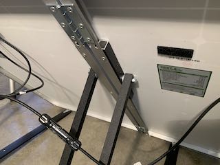

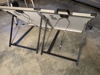

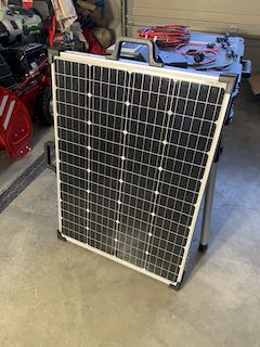

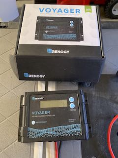

I put together my portable solar panel setup this week. Purchased 2 HQST 100 W Monocrystalline Solar Panels from Amazon along with a Renogy 20A waterproof charge controller. I also bought 20 feet of 10AWG wire with the correct connectors and the male and female SAE connectors. I assembled the panels into one unit with legs made from spare aluminum banisters from my friend's railing project. The unit folds up and the wire and charge controller can fit inside. I also bought a case big enough to store the unit when closed. Additional materials include: hinges, clasps to close the case, nuts and bolts, etc. The wire runs from the solar panels to the charge controller with a 15Amp in-line fuse. From the charge controller I attached the male SAE connector and the female will install on the battery case and connect to the battery with a 20A fuse on the positive lead. I can then just plug and unplug the unit at the batteries and attach the charge controller to the frame with magnets when in use. ![]() ![]() ![]() ![]() ![]() |

Looks nice! Should work out well, and you can always increase the length of the wires to the battery if you find you need more length to get the solar panel into the sun.
I assume you mean the rPod frame when you say you are attaching the controller to the frame with magnets? Nothing else is made of steel I don’t Think. Did you glue the magnets to the controller? Also, it won’t hurt anything that you have made the 15A fuse there but for future reference for others its not really needed. Solar modules are current limited and won’t produce enough current to blow the fuse anyway, unless you have 3 or more in parallel. You do need the fuse at the battery because it can produce hundreds of amps. |

I will attach magnets to the controller so I can attach to frame. May also come up with place near batteries if needed. Even though the charge controller is waterproof, I am looking at a small pelican type box to help protect it. The 15A fuse between the panels and controller is just an extra precaution on my part.
