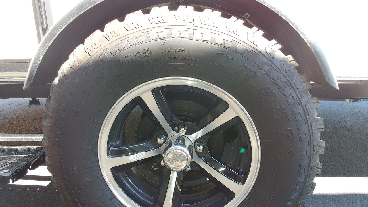

Those are all labeled LT, but if you can order them in bulk, maybe you can change that too. The LT235/75R15 is load rated at only 900kg, which is quite a bit lower than the ones on our RP-179.
Who knows, maybe all the specifications and sidewall marks are written in chalk?

The tires that came on our HRE RP-179 are Westlake CR857+ tires. The size stamped on the sidewall is "ST235-75R15", and they are also labeled "For Trailer use Only". They are plainly trailer tires.
They are a special tire (presumably) ordered by Forrest River for (at least) the HRE R-pods, and probably others as well. There is no after market equivalent, and they are also special because even though they are load range C, they are stamped with a maximum load of 2340 lbs, which is way above what a "typical" load range C tire would handle.
If you were to replace these tires, the closest I have found is ST225-75R15. You would want to get load range D in this tire size in order to get a similar/equivalent load handling capability.
The difference in height is only 3/4 of a centimeter (235 mm - 225 mm = 10 mm = 1 cm). And since it is a "75" profile, the height is .75 of the width, or 7.5 mm. This translates to about .295 inches or a little less than 1/3" (or a little more than 1/4" if you prefer) difference in height.

The Westlake 857+ tires that come on the HR's are 235 75 R15's.  They are ST tires not LT tires.  There is no like size replacement unless you go to a LT.  I have posted several times about my frustration trying to find a same size swap.  If I want to replace with ST tire I'd have to a 225 75 R15, which I'd lose about a 1-2ish in height.  Not a deal breaker since I added the risers, but I'd rather not.
I couldn't find my old post on the topic.  Sorry.  Hope this helps.
