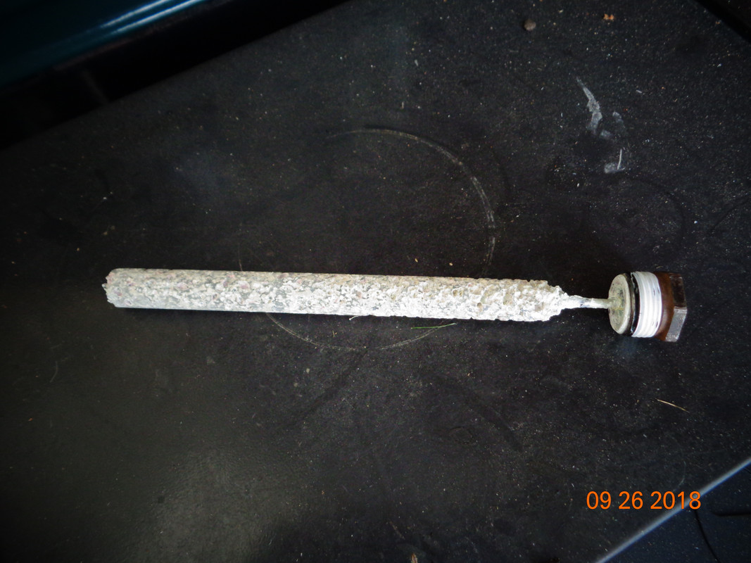

Me Again---Does anyone clean the crap off the anode rod with a wire brush or do you just replace it--mine isn't even a year old yet and I'm not sure what they're supposed to look like---Also--do you ever inspect the heating element?  In my area there is a lot of calcium in the water and I have to take them out and use a wire brush on my home water heater elements

If there's still a fair bit of "meat" on the anode then I do not replace it - they usually last me for 2-3 yrs. I use a soft brush and hose w/pressure nozzle. Important to use a hose/nozzle to clean out inside the tank - just stick it in the hole and rinse away until it seems to be running clear.

We got a little over two years out of our first one, but that's with only taking the Pod out a few times a year. I finally had to replace it before a rally this past weekend.
I don't clean off the anode rod when checking it because I want to keep as much of the sacrificial magnesium on it as possible.

Has anybody bought aftermarket anode rods? Did you have any problems with them?
Should be fine, its a generic item. I've even gotten them at local hardware stores.
