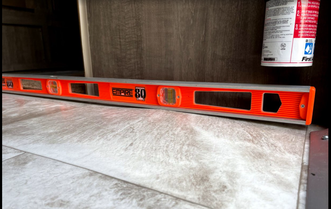

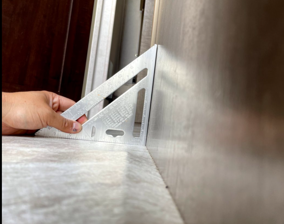

I'm sorry if this has already been asked, but can someone post the dimensions of the FR outriggers? I am interested in the length of the top, and the height of the side to see how they would work on my 180.
I have a bulge in my floor near the door and it looks like one of the floor joists has bent and the floor is sagging towards the wall.
