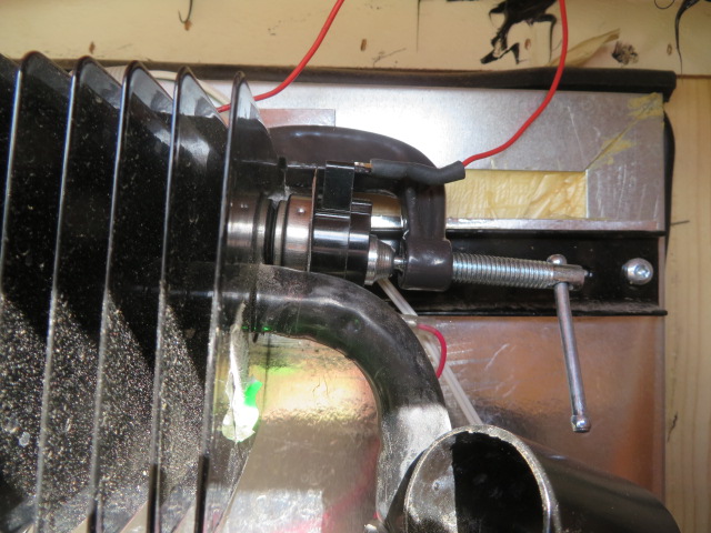

Posted: 14 Aug 2016 at 8:54pm |
I didn't know theire was a fan until I saw posts about cooling the frig. Mine never came on in two summers of camping. I found the switch and jumped the wires together and the fan worked. I think the switch is set to high to work where it was. I got a snap disc switch on at 130 and off at 115 degrees. My issue was that where the factory placement was doesn't get hot enough. I wanted to put it at the far right but could not figure how to attach it to the cooling fin. I ended up going to Harbor Freight and got the smallest C clamp they had. I cut and ground it down and used it to hold the snap disc. The first placement was too hot so just moving it up 1/4" seems to be the sweet spot so it doesn't run all the time. The clamp made it easy to adjust.
