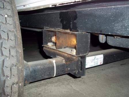

I have read the posts on here about axle risers from Forest River and other manufacturers and installing them to raise the height of the bottom of the pod.  I just bought a 2010 pod 172 and in looking it over, I noticed that the water tank and it's outlet as well as the black and gray water pipes are very low to the ground. I really do like the pod, got it at a good price and it is just what my wife and I were looking for.  I would, however, like to raise the height of the bottom of the pod 3 or 4 inches.  Has anyone out there done any modifications to raise the height of their pod without buying any of the axle risers that I have seen on this site.  Maybe fabricated some yourself?  Used other methods?  Any advice that you can give to me will be greatly appreciated.

You can order axle risers through your dealer or direct from Forest River, this is what they look like.

Last I checked there were no risers available at Forest River or any dealers,  I had a couple pairs made  at a machine shop.  They were made from 2" x 4" tube steel.  Installed myself.
email me and I will send a picture.
