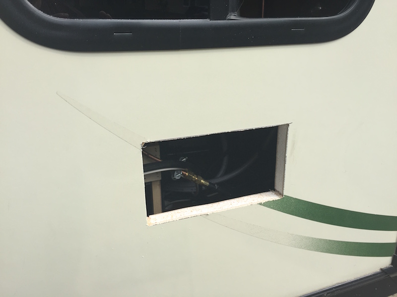

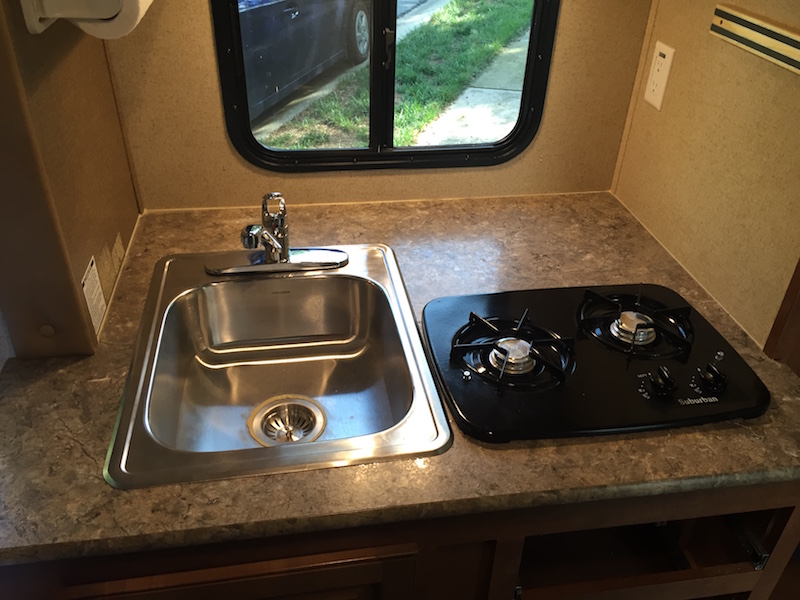

I decided to do the 2 installs simultaneously because it gave me more access to each areas. The only issue I had was having to more the store to the right 1/4". When I measured for the sink purchase I didn't look under the countertop closely enough to see if there was room to accommodate the sink. I had to shift the sink to the right some, that required the stove more. All in all I'm pleased. The exterior shower install went without any issues.
The process went as follows:

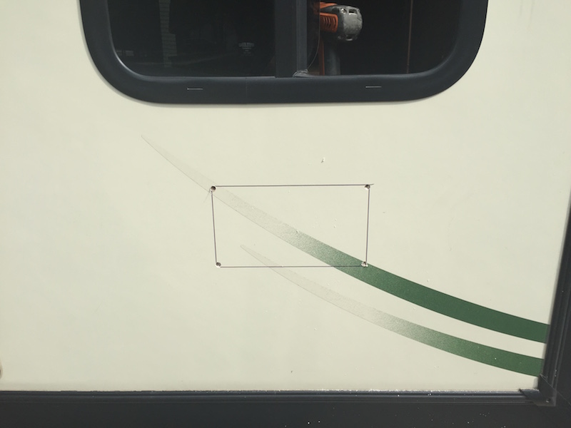

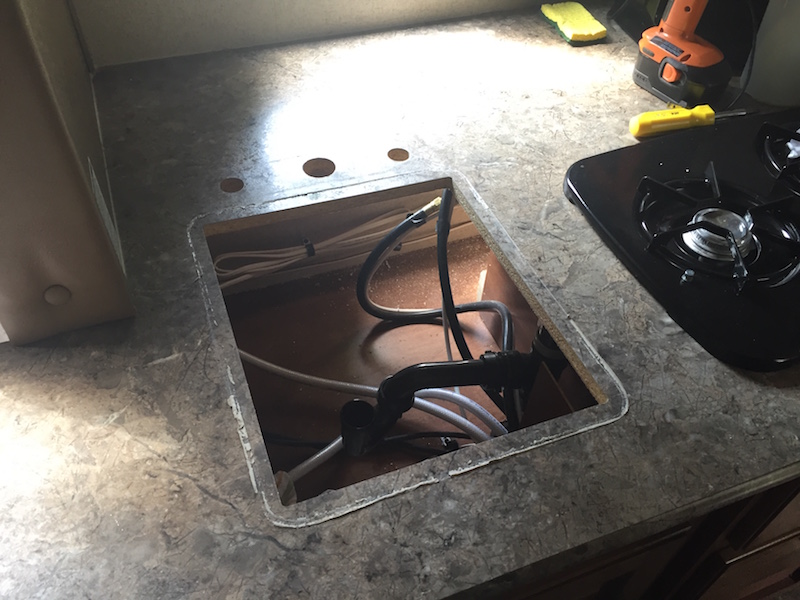

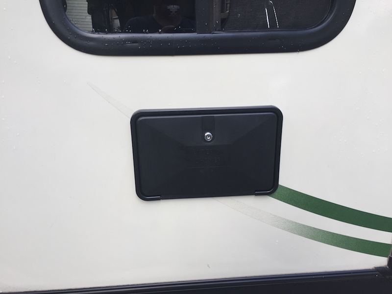

I cut a plywood template the size of the opening I needed for the shower and drilled holes in each corner for the saw blade making sure I was well below the countertop:
I cut the opening with a saber saw:

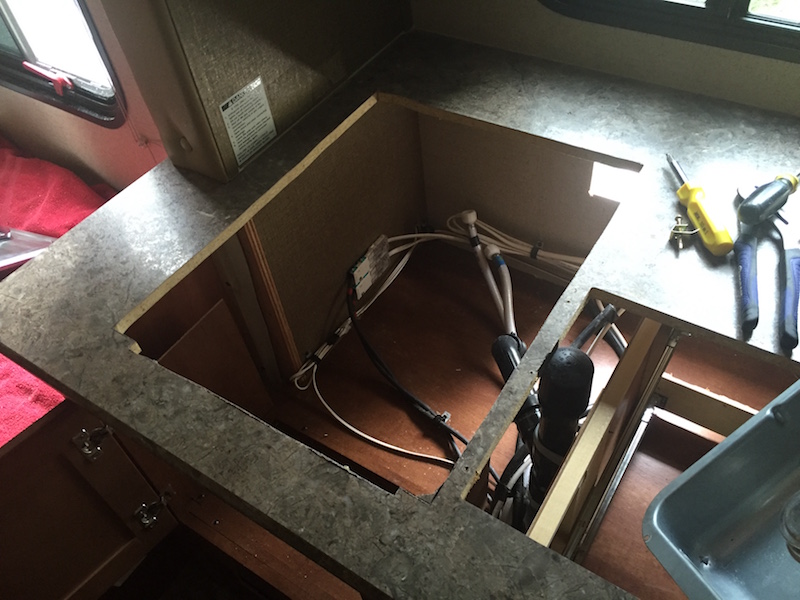

The original sink was a simple removal:
Carefully laying out the new sink opening, I used the saber saw again. I had to remove the stove to cut the countertop, plus I had to move the stove to the right 1/4"

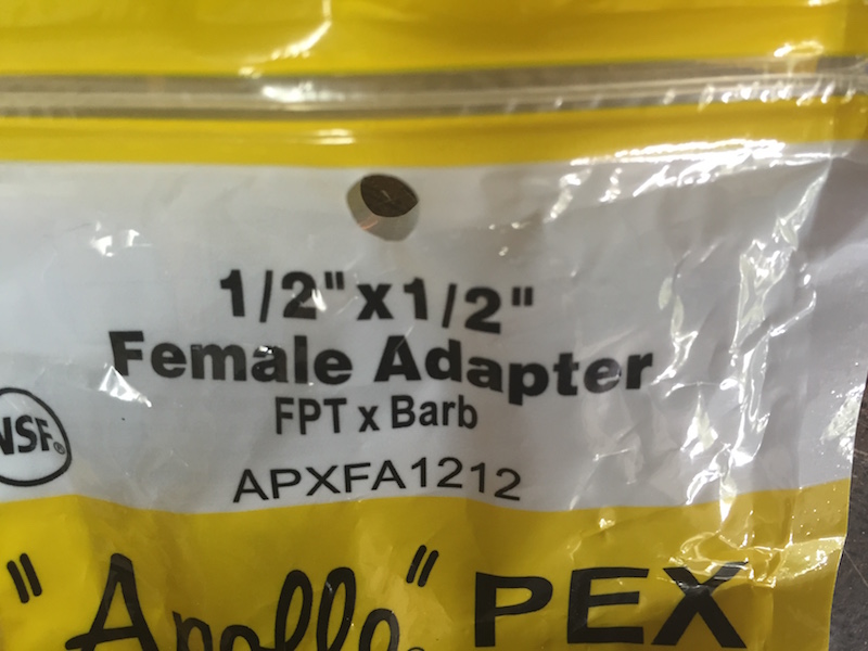

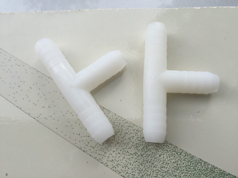

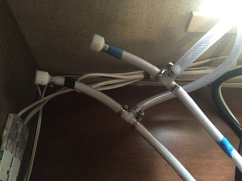

I got these 1/2" T - hose barbs at Lowes and spliced into the hot & cold going to the faucet:

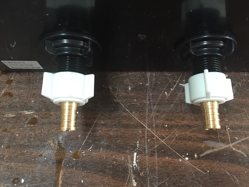

I used a different hose connector than came with the shower for a more dependable connection:
I got those at Lowes also:

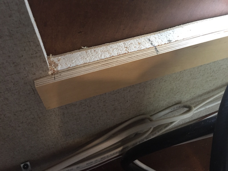

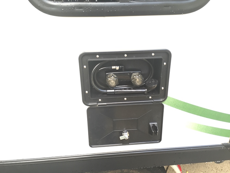

I glued 1/2" plywood backing inside behind the shower on the top and bottom of the opening to provide something for the screws to grab:
Here are the hot & cold lines going to the shower being careful to label them so not to be confused. I confuse easily:
I bought the sink at Amazon:
I opted for a single lever faucet because I was always concerned about hitting the hot or cold knob on the original with so little room. I bought the faucet at Lowes:
I bought the exterior shower at Amazon:
It will be interesting to see how much use it gets:
