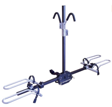

I moved the spare to the tongue and use a Swagman XTC Cross-Country 2-Bike Hitch Mount Rack on the back. What I like about this style of carrier is the tires sit in a cradle so the bikes don't move around at all. It fits 1-ΒΌ" & 2" receiver and the hitch pin is threaded so you can wrench it down tight to minimize bounce. I gotta believe our 2 bikes plus rack doesn't weigh much more than the spare and mount.

+1 for the same reason I stated for using an extension.  Instead of the bikes occupying the space where the spare tire is sitting (in mid-air) they will be at least 6 inches farther back.  The pod's rear receiver just isn't designed for much dynamic loading and that will increase the dynamic loading a lot.
