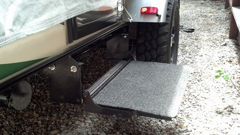

I also have a 179 and found the step was just a little too small. We had a Coleman tent trailer and we liked the design of there step. I added on to the existing step to make it larger. It still folds-in.
Leo B
podders Helping podders - pHp Joined: 13 Jan 2012 Location: Lyndonville, VT Online Status: Offline Posts: 4511 |
Posted: 01 Jun 2015 at 6:15pm |
Nice work!
