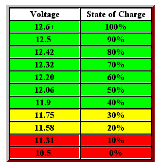

Hi Leigh,
I would suggest *not* running the battery so low that you couldn't close the slide. It's really not good to discharge a 12 volt battery that much. I've attached a good guide for monitoring the battery voltage. Of course, you would need a gauge. Personally, I carry a portable gauge and I installed a 12 volt gauge to monitor batteries. Using the built-in battery lights gauge, I wouldn't let it get below half. You will probably damage your battery by letting the voltage drop below 11.9 volts (40% state of charge) although your slide will still pull in.
Hope that helps. Fred
