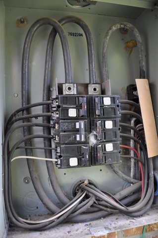

The question: What is the, if any, preference for the tap point on the house: 1) the feeder at the "utility in" located outside using a double pole breaker(because it full), or 2) tapping at the service panel inside the garage?
I'm just wondering what the normal go to is in this situation, if there is one.

The "utility in" is on the side of the garage near the front, close to the driveway. The house breaker panel is on the back wall of the garage, so with the POD parked in the driveway, the run should be no more then 30', either way.
There is no open space at the "utility feed" however, I think a double pole 30amp thin breaker could be used to replace one of the existing full size breakers, so I can tap in for the POD.

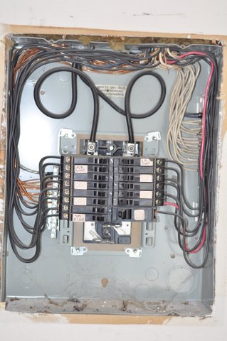

I have additional space available in the garage "House Panel" but I'll have to check with a pro on how to setup 30 amp service at that point.
I have done a fair share of electrical wiring, but have never messed with anything a the panel level. I do have a load center at the utility feed and a distribution panel in the garage. At this juncture, I'm trying to figure out if it would be best to tap at the "utility in" or at the house panel inside the garage.
Not sure there is and advantage with one, over the other.

The pics...
Outside...All 220v appliance feeds. There one 70amp breaker marked (main/sub panel) Inside (sub-panel in the Garage) 120v feeds, light, plugs, etc... Question: How do I identify the correct breaker, I looked at everything within the panel and on the breakers and it's not clear to me what type I need. Am I stuck with pulling one out and taking it to the parts house to match it up?
