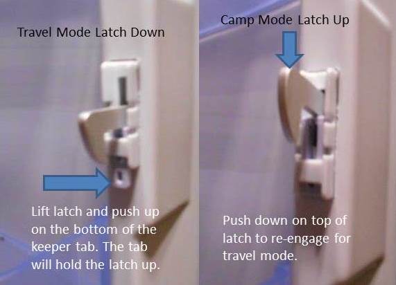

Camp mode? Travel mode? I guess I've missed something. How do you put the fridge in travel vs camp mode?

[/QUOTE] Camp mode? Travel mode? I guess I've missed something. How do you put the fridge in travel vs camp mode? [/QUOTE]
As they say...a picture is worth a thousand words... Without the latch in play (camp mode) the door works like a home Fridge, you don't have to push the latch button to open, just pull the door open like at home. Saves wear and tear on you latch and prevents accidental pulls on the door when the latch is engaged...easier to open. |

Thanks! I hadn't noticed that difference before. Turns out ours has always been in travel mode. What is it they say? .. When in doubt, read the instructions? What a concept!

Then there is also between-camp (or winterization) mode. The catch - the part mounted on the wall inside - will slide forward to keep the fridge open a crack to prevent odors and mold.
