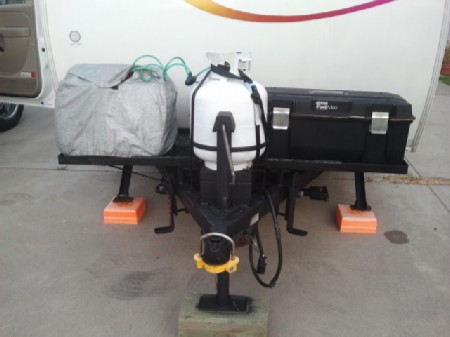

Just bought a small Champion generator (L18"X15"X15" and 58 lbs) and I want to carry it on the trailer tongue. I plan to put a metal shelf behind the propane tank and put the 2 batteries in a box and the generator in another one. Has anyone else done anything like this?

I did something like that.
http://podterfly.blogspot.com/2008_07_01_archive.html
The blog has before and after pictures.
LeeStar
Still a work in progress, lots of pictures.

I plan to remove the generator from the tongue when I use it. I'll then let it cool before I replace it. Thanks for the pic and blog reference. They have given me some ideas to chew on.

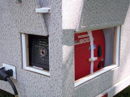

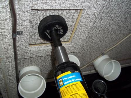

My gen. is build in, to eliminate noise and vibration I lift the gen. by about 1/4-1/2" with a bottle jack it works great.

Is that the bottom of your trailer? Do you have other pics of where the generator is installed?
Posts: 1004
Direct Link To This Post Posted: 21 Feb 2013 at 8:06pm
The gen. is in a box in the back of the trailer. I also diverted the exhaust to the ground to reduce the noise.

Direct Link To This Post Posted: 22 Feb 2013 at 1:26am
Looks great! How is the box attached to the back?
