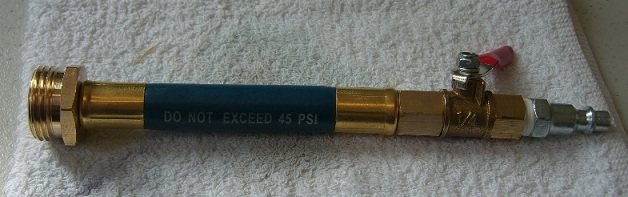

One more try... Below is a combination of the two previously shown blowout solutions. It is the Camping World blowout hose with $4 of parts from Home Depot's air tool department. My mini compressor has a reg on it, so that part is covered.

I don't know if the picture will show up, but below is a combination of the two previously shown blowout solutions. It is the Camping World blowout hose with literally $4 of parts from Home Depot's air tool department. My mini compressor has a reg on it, so that part is covered.
