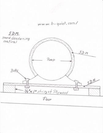

I turned my noisy clonking pump, I rated it at a noise level of 10. Turned it in to a soothing purr, noise level 1.5. If anybody is interested I can make up a sketch of what I did, and post it.

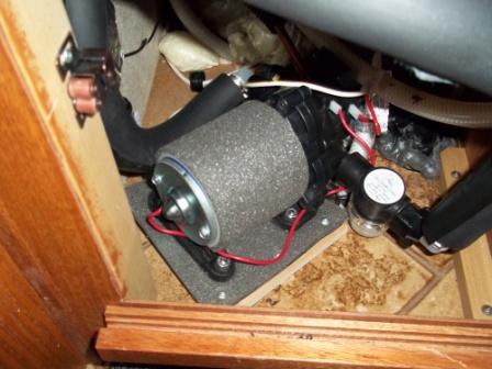

If a rubber mouse pad is not sufficient, you could mount the pump on a 'sound absorption' pad.
It allows you to bolt the pump to the pad and then using separate bolts, bolt the pad to the floor.
That is what I did, it made a big difference in noise level. I also installed some foam insulation sleeves (used on water pipes) on the hoses that run to and from the pump.  That also quieted down the pump noise.

First I covered the pump body with SDM (sound deadening matirial), this matirial is a membrane of 1/8" vinyl and 1/4" foam. Than I mounted the pump on a piece SMD, that I mounted on 2 strips of plywood that are screwed to the floor, the pump is floating. Now where ever a tube is touching another tube or a cabinet, wall or anything else put a piece foam around that tube at that spot, if the pump is still banging you mist a spot. The pump should purr like a kitten. Good luck it works. I also reduced the noise level of my 2000watt honda by 50%.
