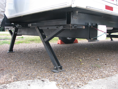

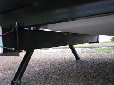

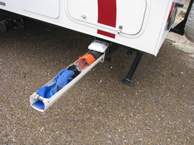

There is a mod which some have done including myself which you use a 6" X 6" X 8' PVC fence post with a piece of PVC guttering which slides in and out with covers on each end.  It's a very easy mod maybe about 2 hrs. and very handy.

Last fall there was a Forum thread about hanging a 4 1/2 x 4 1/2 square PVC fence post for hose storage. I found that my plastic hose ends barely fit inside the post.  I second the recommendation by 'pmjensen' to use a 6x6 PVC post.  Your hose will store more easily and using a PVC gutter as a internal slide is also a great idea.

Here are some picts of my take on the sewer hose holder.  Since I have axle risers on Nuestro Pod.  I opted to mount in back.  Plus it was easy to work in that area.  Prior to mounting, I sprayed mine with a bed liner spray from Walmart just to give it a little more protection from rocks etc.
