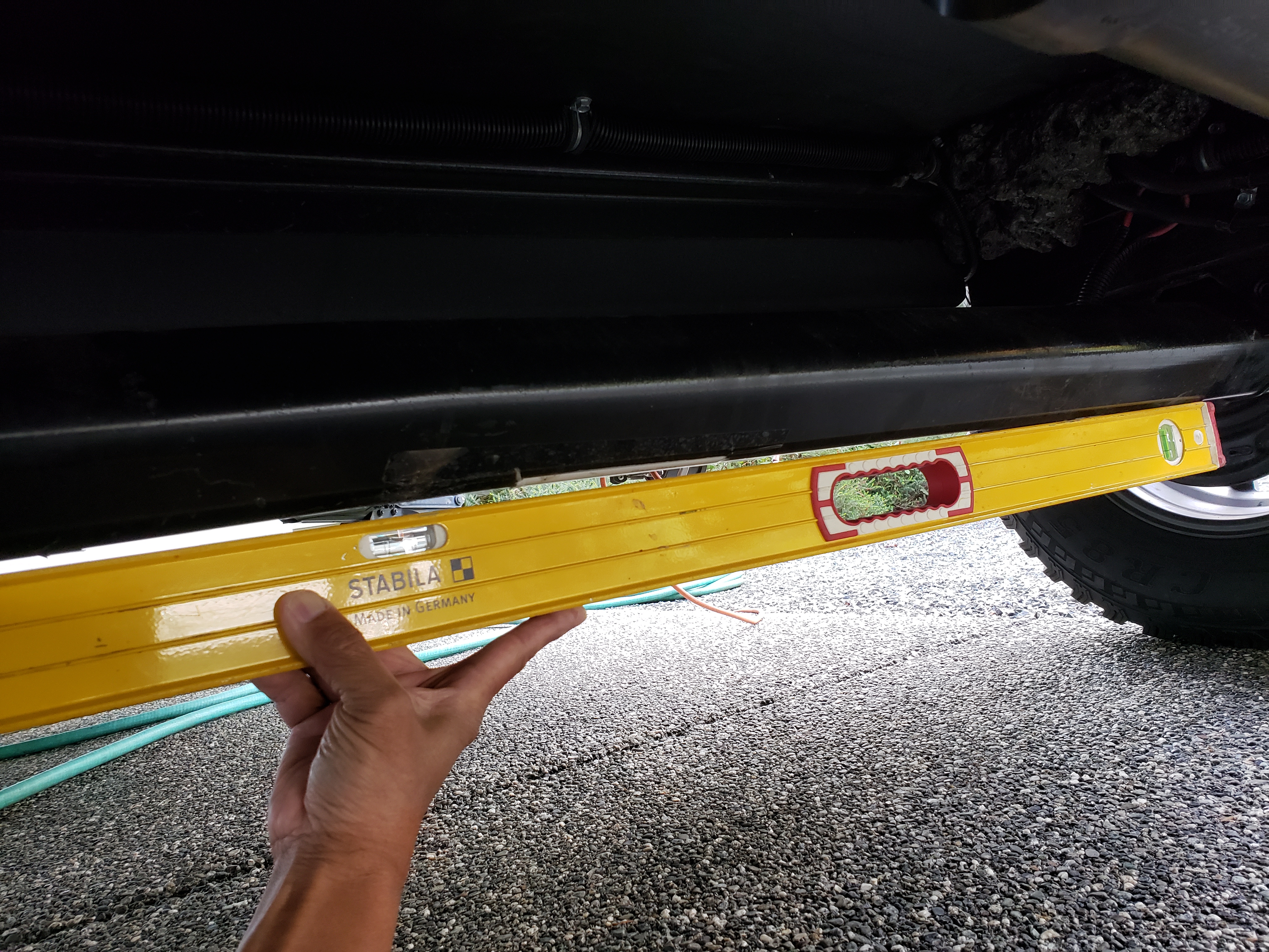

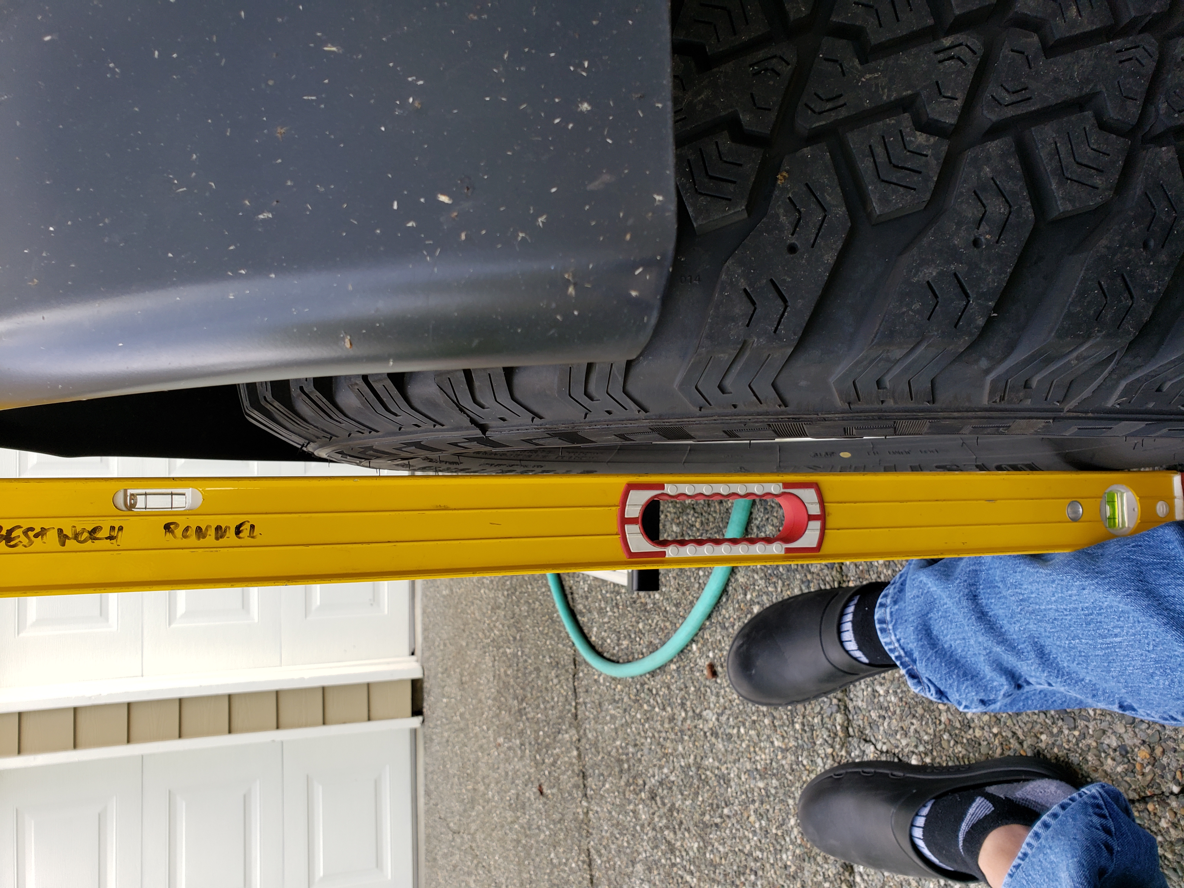

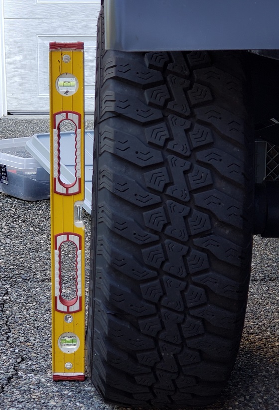

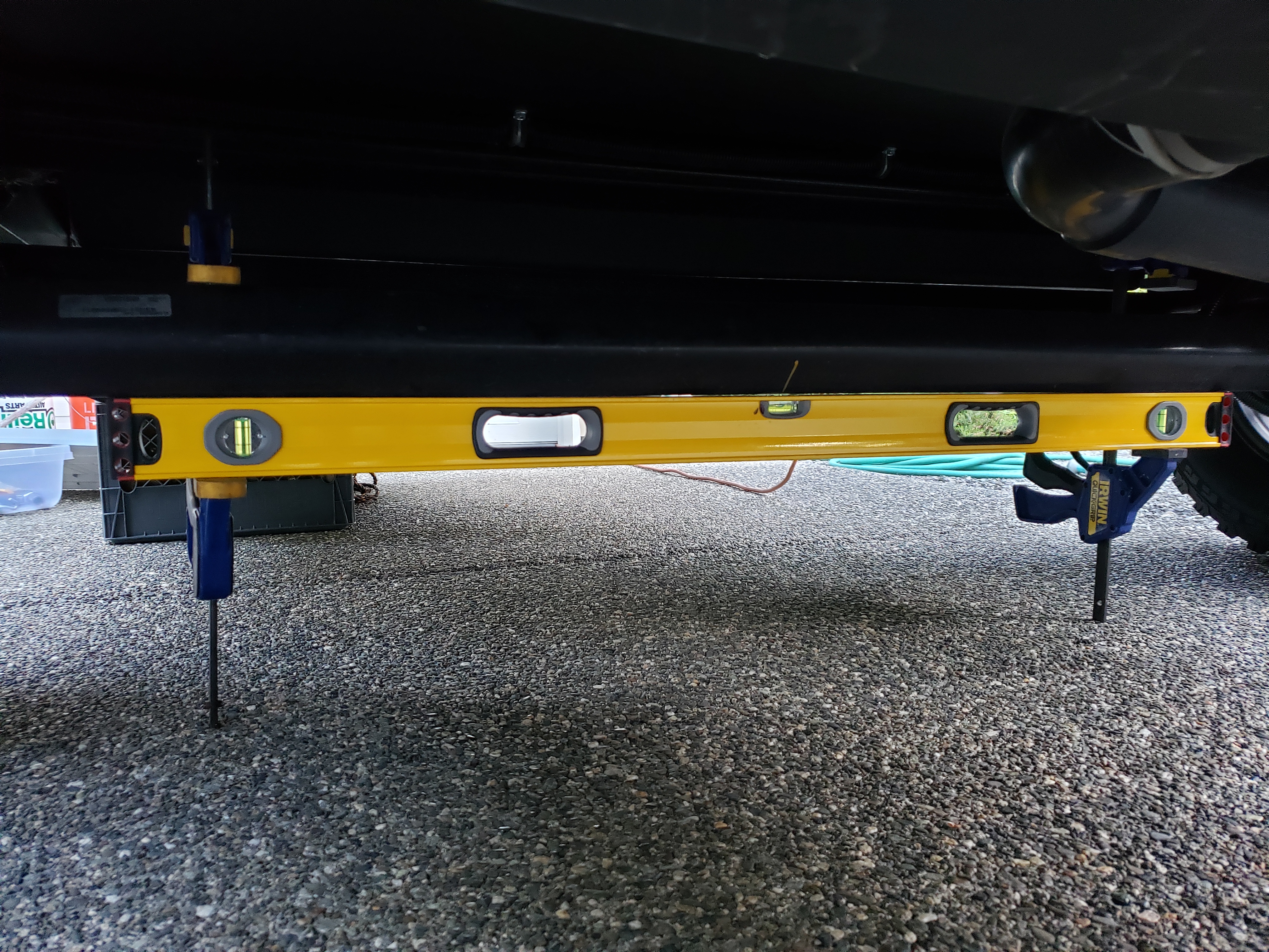

Originally posted by kcisland
It is well documented here on the forum.
The axle is only rated for 3500 lbs with dry weight of 3200 lbs leaving about a 300 lbs cargo capacity.  Not much when you consider water hose, electrical cords, wheel chocks, food, pots and pans, clothing...it adds up fast.
Top that with the unit's frame supports being too far inboard from the ends causing a cantilever, the camber can be lost from overloading and hitting a big bump.  It is very evident when your wheels toe in at the top.
Good camber:  About 1/4" gap with a straight edge.
Bad camber:  No gap with the straight edge.
Wheel tipped in at the top:
Offgrid's fix is a 3x3 structural angle supported by opposing U bolts to help stiffen up the cantilevered axle location.
