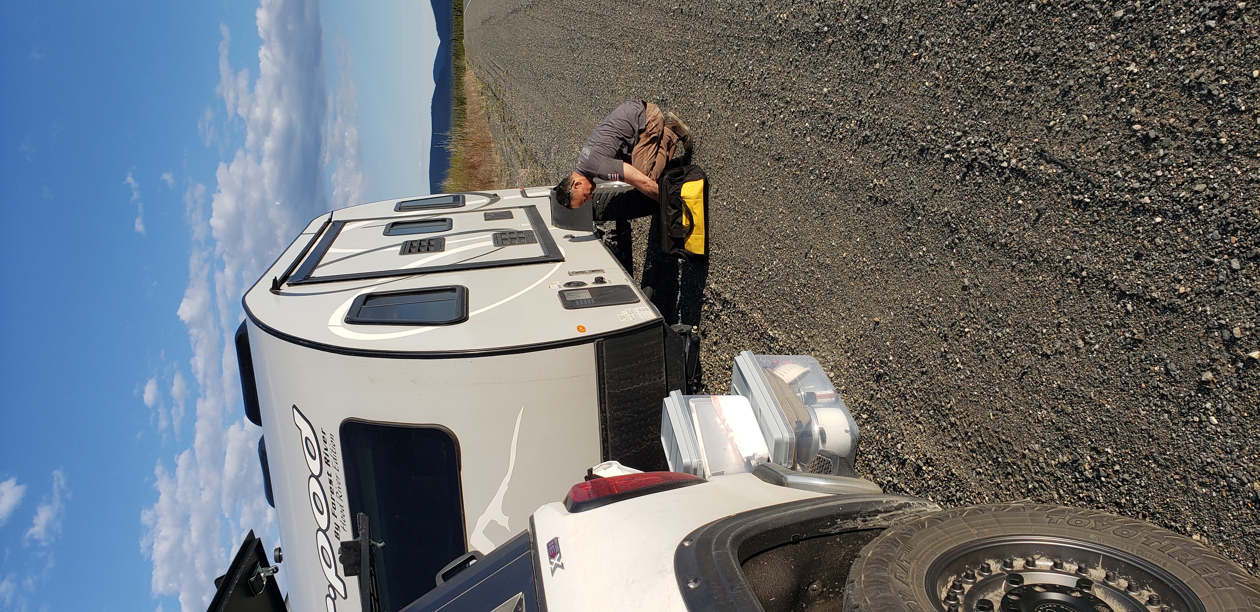

Roads – The road reports are always subjective due to people’s experiences and what vehicle they are driving.  The lower part of BC is pretty good, similar to the US.  The upper part of BC through the Yukon and into Tok, AK got progressively worse starting with the standard perma frost roller coaster heaves, moving on to cracked asphalt, on to huge potholes and drop off’s.  There were stretches of road that were gravel or pure dirt/mud and a lot of road construction with long wait times for pilot cars to guide you through.  The Canadian border to Tok, AK was the worse of the whole trip where I didn’t go any faster than 40mph for stretches due to the breakup and undulations.  This stretch did a number on the 190 loosening up everything (see R POD report below), but then we did a stretch of over 70 miles to a small village of Manley Hot Springs that was all gravel washboard that shook the poor 190 to bits.
R POD – Despite the following report it did as well as it could under the conditions.  First of all I was glad I did the Offgrid axle support.  After the first incident of lost camber, a new axle, and adding the support, I have really watched the cargo weight and only ran with a 1/3 full freshwater tank and minimal supplies.  Despite the potholes and major slams encountered, the axle camber held great and the wheels are vertical.  But…
