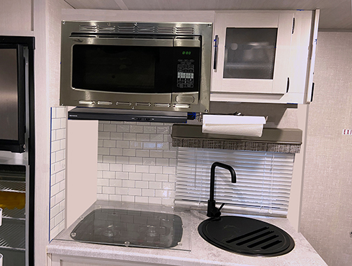

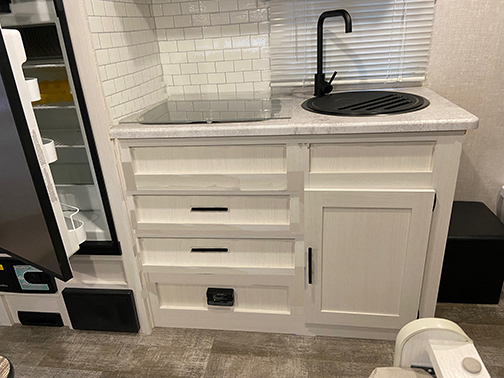

![]() ![]() Here goes, I now have 2 useable drawers and a microwave I do not have to pray to! These are just renderings, actual project not completed yet. With the weight of the microwave up top I had to add reinforcement walls to both sides of the upper cabinet. And make the right upper cabinet smaller. |

Be sure you maintain the required safety clearances if you move that microwave. You might want to look at getting a low profile over the range microwave with integrated ventilation. That would be designed for the heat from the stove top. I doubt the standard rpod microwave is.
Olddawgsrule ![]() Senior Member ![]() Joined: 20 Sep 2017 Location: New Hampshire Online Status: Offline Posts: 1014 |
FR not does mount anything heavy from the walls. When I replaced the upper cabinet I learned why. I replaced because it was falling off and poorly constructed.
Reinforcing the sides is very important, I did the same just for the cabinet (not near the weight you will have). Honestly, I would totally rebuild the cabinet on the right and add a shelf under the micro to support it. I would not rely back the micro hanging bracket alone.. not in a camper! I would also reinforce the back wall. With all this done, I would think it would actually stay in place. JMHO P.S. We took delivery without a microwave. We rarely use the one at home, never have while traveling and preferred the space for additional storage, but that was us. |

I would be very concerned about the cabinet strength too. I had to reinforce my overhead shelves on my 195 last year. They were separating. They are held up with small screws that can easily pull out with a little weight on them, going over bumps. Not saying it can't be done, but it must be reinforced in my opinion as well. My 195 has the low micro also, but for the limited number of times I use it, mmmfff

Where did you find the wood that matches the original wood?
