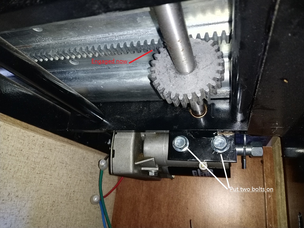

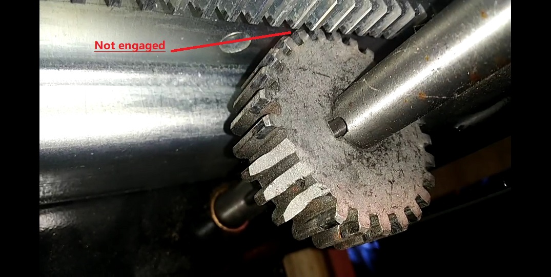

Symptom:
Motor is running and sounding good but no movement. What I found: Open the two panels under kitchen. Two bolts holding the MOTOR-AXIS-GEAR set are off. The gear on MOTOR-AXIS-GEAR set and the gear rack on the body of slideout are not engaged. Solution: Find the bolts on the floor. Put the MOTOR-AXIS-GEAR in position and make sure the gear and gear rack are engaged well. put on and tighten the bolts. I found the mechanism of rPod RVs is very simple. There is no any sensors, detectors and control circuit. Therefore, when you sliding in or out, release the button immediately once you hear the sound of clicking. |

poston ![]() podders Helping podders - pHp ![]() ![]() Joined: 28 Mar 2018 Location: Nevada Online Status: Offline Posts: 199 |
Looks like some teeth broken off on the gear?
-- Jim Virginia City, Nevada 2016 R-pod 180 2015 Nissan Xterra Pro-4X |
I would try to get a new pinion gear before those broken teeth destroy the gear rack.
