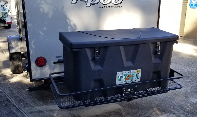

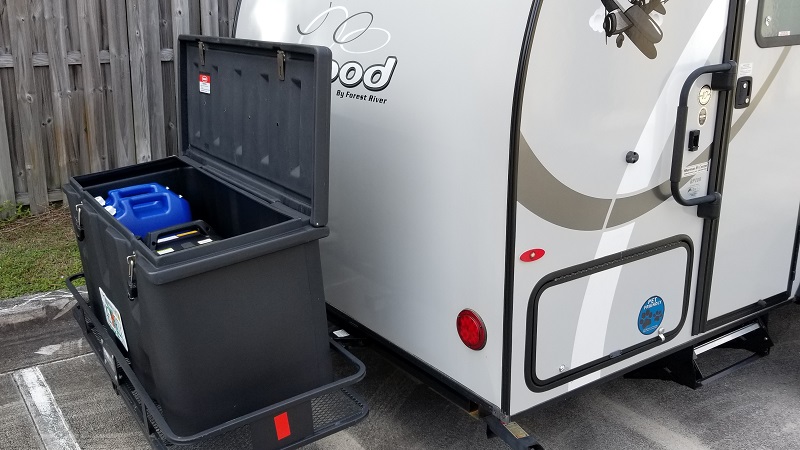

aimsghali, this isn't an ego thing, its a safety thing. It is a safe bet you NEED to listen to the good advice and reasons behind it posted by the experienced members of this forum. I am not new to towing, but don't have near the experience of those who have cautioned you, and I can see nothing but trouble from your set up. Best of luck.

Direct Link To This Post Posted: 19 Apr 2021 at 6:04pm
There are no mandatory design limits for the structural forces over the road vehicles are required to withstand. I've looked. Best I've seen are recommendations for heavy trucks that they should be able to at withstand forces in the range of 2.75 to 3 g's. Light vehicles like cars and pickups are tossed around more so have to be higher. The actual design limits used are company proprietary.
In contrast, I've run the numbers on the rpod frame and it's under 2g's at the axle. You can get light and cheap, or you can get strong and heavy, or you could probably design something fancy like a unibody trailer box and get strong and light, but it wouldn't be cheap. But you can't get all three. Rpods are light and cheap, don't for a moment assume they are strong. They aren't.

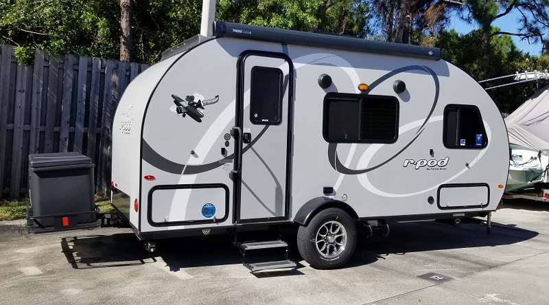

Direct Link To This Post Posted: 19 Apr 2021 at 4:56pm
WOW!

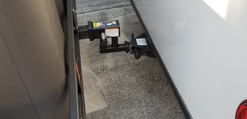

Weigh the original spare and tire mount.  Measure the horizontal distance from the pin hole in the original hitch to the center of the tire.  Multiply that by the weight of the tire/mount assembly.  Then, divide that by the horizontal distance from the pin hole to the center of your hitch basket.  THAT is the safe weight limit of the hitch for a load in the basket.  I doubt it be as high as the weight of the basket alone.  That huge lever arm the basket has against the OEM hitch is like adding a pipe to a wrench to loosen a bolt.  Plus, a bouncing load can easily add 2x the force of a static load.
That long lever arm is why the frame WILL bend at the axle if you do that often enough.  The stress flows in the frame to the axle where it is transferred to the ground.  The max bending stress is at the axle; that cheater bar thing again.
Put your storage box inside the trailer over the axle.  Do not exceed the Gross Weight limit of the trailer or axle.
I know this sounds harsh.  I hope it is about as harsh as the bouncing generators and gas cans will be when it lets go on the interstate.  This is not 1970s design engineering (there is no excess capacity).  With computers, that frame can be sized to within a very few percent of design loads.  You can be sure FR did so to get the trailer weight so low.

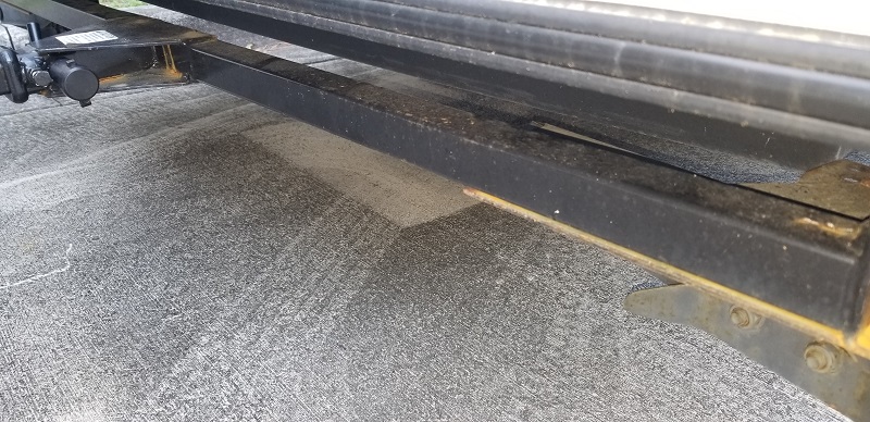

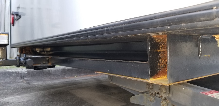

Direct Link To This Post Posted: 19 Apr 2021 at 3:53pm
If you hit a bump or pot hole with the trailer wheels two forces will combine to put bending stress on the box tube frame rails. First is the g force from pushing the trailer up, that creates a stress on the frame where it is connected to the axle bending the frame downward as it tries to lift up everything loading the trailer behind the axle.
The second is the torque created by the torsion axle hitting it's stop as it gets pushed upward. That torque will try to twist the frame where the axle is attached. These two forces combine at the point where the rear of the axle attachment bracket is connected to the frame.
The more weight hung off the rear of the trailer and the farther out it's placed from the axle the worse the bending forces are. That's because the frame is a big lever or teeter totter as LA explained.
The tube frame is pretty thin in order to keep the trailer weight down, so the safety factor designed into the frame at that point to handle these loads is minimal, only around about about 2g's or a bit less. It's the weakest spot on the whole trailer, along with the axle itself, but that's a story for another day.
It's pretty easy to get a 2g load hitting a pot hole or bump. We've had one member report their frame bending at exactly that spot.
If I wanted to hang stuff off the back of the trailer (I don't because it reduces tongue weight which increases sway) I would strengthen the frame at the axle by adding a second 2x4 tube under the frame, and eliminating the axle riser. The second tube wouldn't have to be very long, a 4-5 ft piece centered on the scale would do it. That's because the bending forces fall off quickly fore and aft of the axle.

Direct Link To This Post Posted: 19 Apr 2021 at 3:45pm
I think that trunk would be okay if you used it for a couple of lawn chairs and cushions. Anything beyond that is asking for trouble. The force of 150 lbs that far out gets multiplied. Hit a bump, and the whole thing is likely to be bouncing on the highway. Generators are too expensive to risk that way.

Direct Link To This Post Posted: 19 Apr 2021 at 1:52pm
Think of your trailer as a teeter toter with the pivot point at the axle attachment.  I think that is what OG was referring to when he said that would be the point at which it would bend.  There is nothing between that pivot point and the end of the trailer cargo tray that supports weight from the ground up.

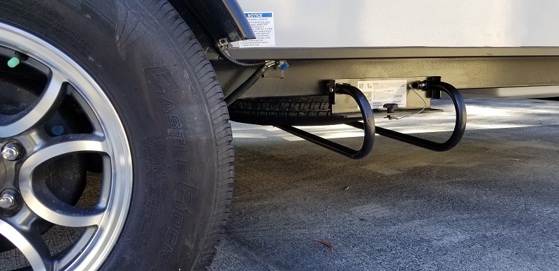

amesghali View Drop Down
Joined: 16 Aug 2020
Posts: 5
Direct Link To This Post Posted: 19 Apr 2021 at 12:47pm
Thanks for the great tips on reinforcing the hitch bar.
At this time I don't intend to load that hitch more than 150 lbs.  I believe that weight will be safe.
I don't understand what people mean by "the frame bending at axel attachment points".  The only thing that I can see that would bend or warp is the 1.25" hitch cross bar that is welded to the 2x4 main frame.  I can't see how loading up that hitch can bend any other frame components.
I'm a noob at this. As I take out this 2020 R-Pod on the road, I'm sure I will learn more.  I will post updates as they happen.  I'm hoping the learning experience will be peasant.  I hate learning from mistakes.  Big smile
