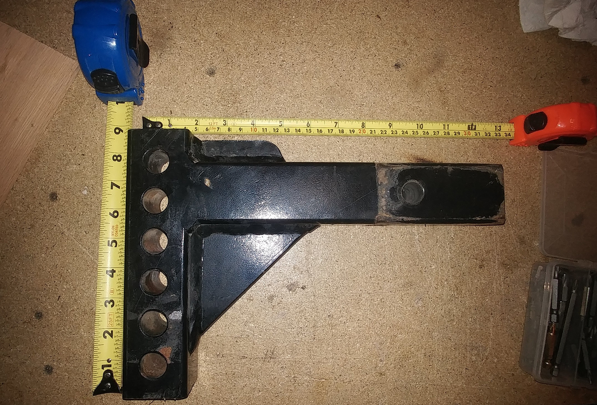

Here lies the problem at hand.  Today I went to adjust the e2 (trunnion 6,000) hitch.  With the Highlander we had the shank that came standard with the e2 in the up position to get to our coupler/ball height at 20ish inches.  I turned the shank downward and could only get the ball down to 25ish inches with the lowest holes.  I need to drop another 5 inches.  What length downward shank do I need?  Frankly I've tried watching videos on etrailer and youtube, but it's not creating easy math for me.
My current shank is this.  The arm that goes into the receiver is 12 inches and the rise or down arm is 8.5 inches.  What length drop do I need to add another 5 inches of drop from this shank?

Thanks Stephen.  I went to the Equalizer website after some more browsing.  They have a shank selection tool where you put in the measurements (ball, receiver, coupler) and it'll provide you with the right shank.  The tool came back with the one pictured above.  Prime from Amazon.  It'll be here Wednesday.  When I get it hooked up, I'll send along some pictures of the new setup and TV.  I'm really excited.

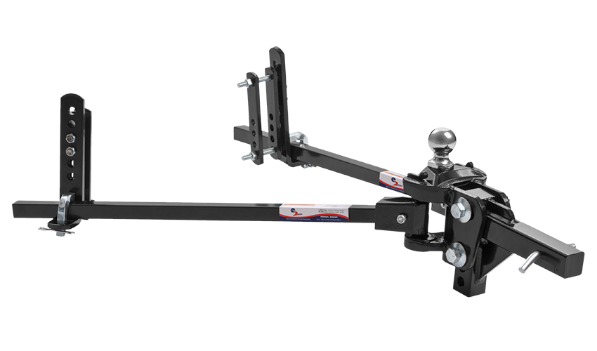

Glue Guy, the top of the receiver is 24, so the bottom is 22.  Do you use a e2 trunnion or the round bars.  That may make a difference.  Mine looks like this.
Top of my coupler on my pod is 20ish inches from the ground.  So I need my ball top at 20 inches.  The head unit on the e2 is 5 inches +/- and the ball is a 2 5/16.  With the stock shank the lowest hole on the head in the lowest position on the shank, it only got the top of ball down to 25.  If I was not using a WD head, I would not have to drop that low to get top of ball to 20.  But with the WD head on the e2, I have to account for lots of room (5 inches) under the ball deck.  Hence this shank.  https://www.equalizerhitch.com/store/shanks/specialty-shank-2-shank-12-long-x-9-drop-13-rise
Glue Guy, if you are coming up with an idea I've overlooked, I'm all ears.  I trust your math implicitly on the tires.  The only area that I'm not 100% on is the top of coupler height.  We've had good snow here in Idaho this year.  I work hard to keep the pod clear and the area in front.  I dug down into the snow and ice to get to ground level, but my side yard is loose stone/gravel.  My 2017 green 179 HR with risers is coming out at 19.5 for top of coupler height.  It could be higher, but not much more.
