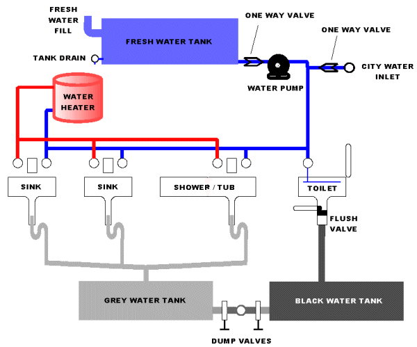

It is basically straight line. From either fresh water tank or city water, with exception of syphon line. The cold water side is basically uninhibited or controlled.
Let's see if I can post plumbing diagram:

Thx for the diagram. So I shouldn’t worry if no AF came out of the outside drain?
