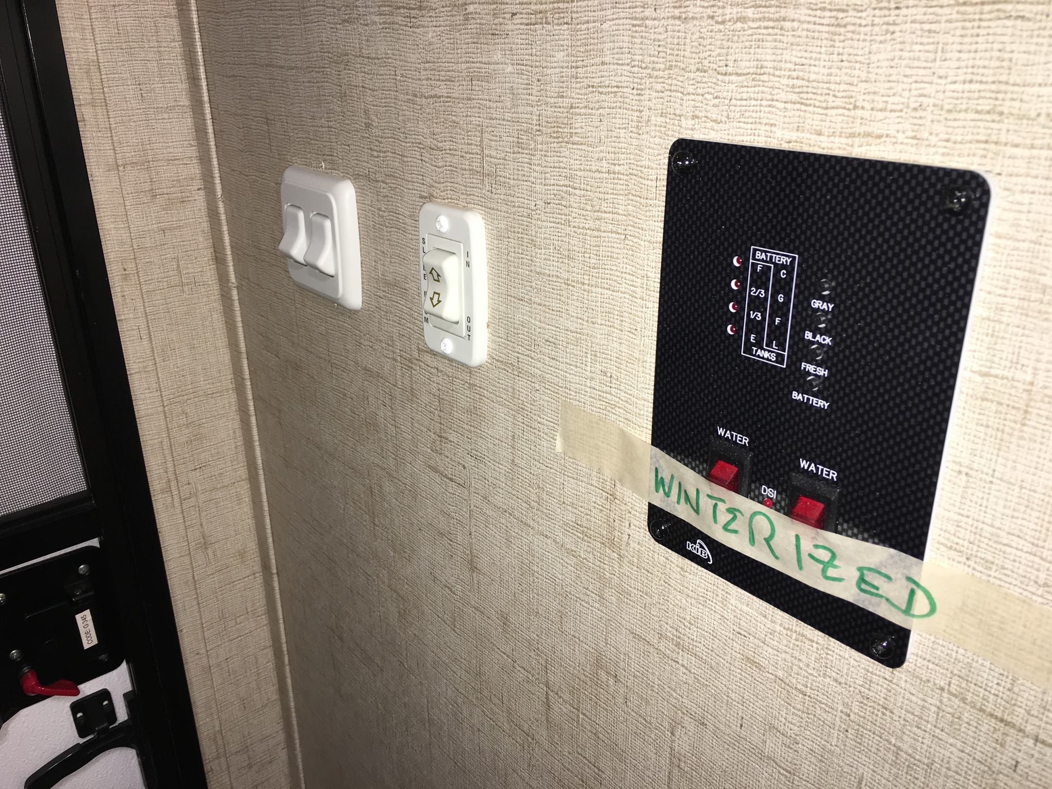

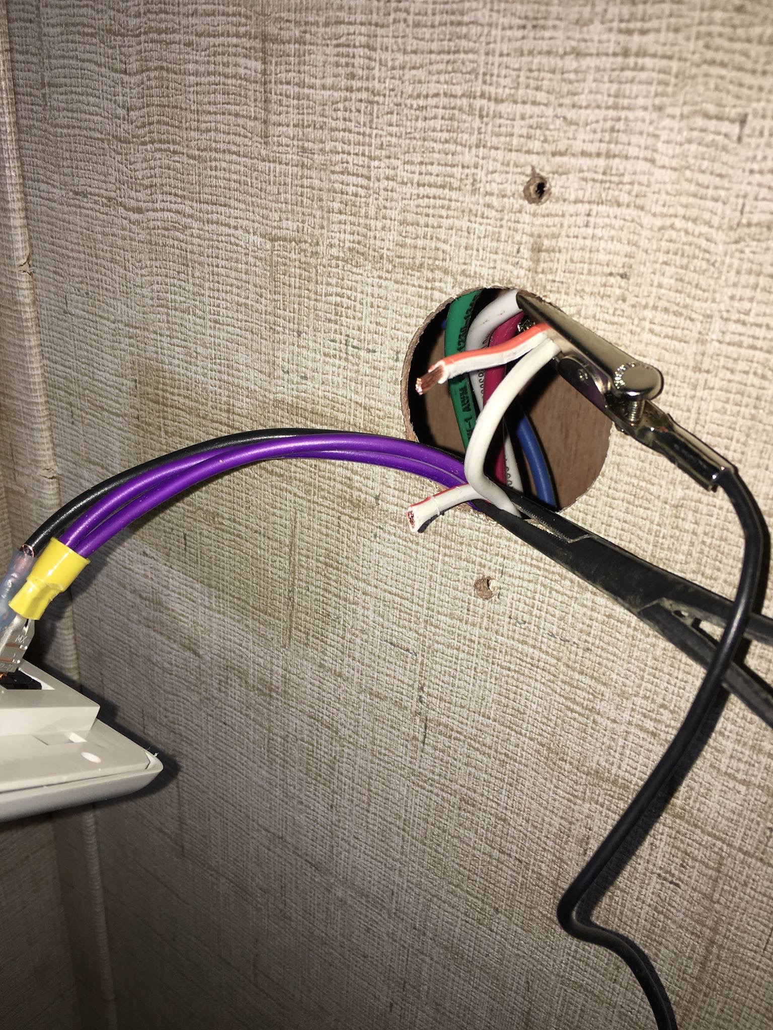

I finished the project to install a wall switch for the overhead light nearest the door. By design or coincidence that light was on its own circuit and the wire ran from the panel to the ceiling right behind the existing switches just inside the door. I removed the old single switch controlling the porch light, pulled the wire matching the color I observed on the  circuit through the existing hole, clipped the hot wire and installed those ends and the porch light on a new double switch that I found on Amazon that nearly matched the style of the existing white slide out switch.
I wonder if Forest River originally intended to install a wall switch for that one light on some models then chose not to for whatever reason. Now my boys can reach the light switch and any of us can step inside the door at night without needing a flashlight for the first couple steps.
