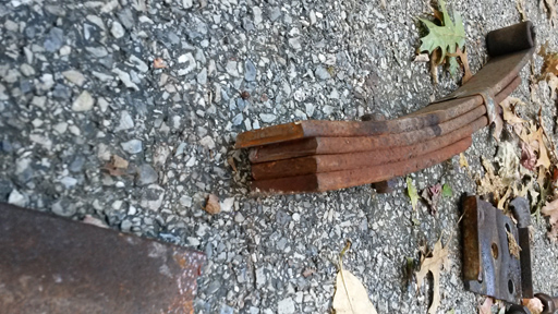

The rest of the rust was just surface rust so I wouldn't worry too much about it if you have a camper with springs. The pods have torsion suspensions.
I think the root cause here was undersized and/or defective springs. Seeing the new one next to the other 3 older springs (that are completely flat under load) makes it obvious all of them need to be replaced. One of them even has a slight bend on the upper leaf in the wrong direction. The new one has a noticeable bend upward like it should.
Which is why I took a deep breath - knowing how much labor was involved to change just the one broken spring - and ordered 3 more. These are all rated at 2600 pounds (10,400 total) so far more than the actual load of around 7000 pounds when it is ready for a trip. All new mounting bolts, too. I am re-using the u-bolts and tie plates although as I was removing a bunch of stuff yesterday I managed to snap one of the u-bolts. Ordered another today and that wasn't easy to find with the specs I needed.

3 springs down, one to go.  You can see the proper bend in the new spring, and the flat old spring.  It even has a slight bend in the wrong direction on the uppermost leaf, on each end.  Now with both new springs on the left side it is sitting 2 1/2 inches higher than the right side.  Hope to continue tomorrow!

Yipee-kayay! DONE. WOW that was a big job. I'll take it for a test tow tomorrow and then check it over to make sure nothing worked loose. Can't wait to get a larger air compressor for those air tools.

   Looks good! That was a big job, now you have a little more ground clearance. With stiffer springs I think that it would handle better towing. Thumbs Up

Took it for a test tow yesterday and I definitely feel an improvement.  No "lumbering" back and forth (the top swaying left-right), more stable overall.  I didn't get a perfect test though, since I didn't do what I always do before a trip - check the tire pressure.  All of the tires were fairly low so it should feel even more stable next time I put it on the road.
