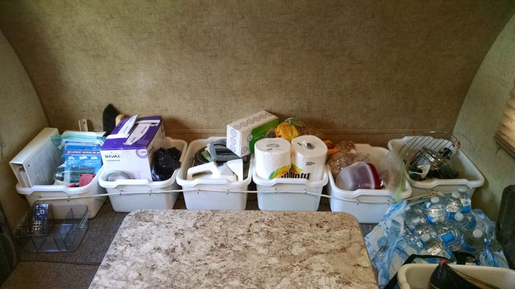

We've done a number of mods where other folks have led the way. Right now we are experimenting with the U-shaped dinette. After strengthening the structure supporting the seats, cutting plywood down a bit and velcro-ing back cushions to the walls, we turned our attention to the back. Since only I and my darling wife (just had 33rd anniversary of our First Date!) camp in our 179, we took off the back cushions and laid washtubs along the seat. The relatively loose retaining cord keeps things in place but still permits some access to underseat storage. We like the idea of living out of buckets!
![]() We probably will put a small shelf with rails above the valences. |
