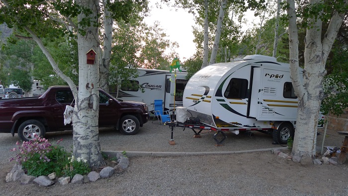

2013 Honda Ridgeline, max tow capacity 5000 lbs., gross combined weight 10085 lbs., gross vehicle weight max 6050 lbs., trailer tongue load 600 lbs. Curb weight of truck 4491lbs. I do not have a weight distribution hitch, Honda does not recommend them.
I took a quick trip from Sacramento to Willow Springs RV Park 6 miles south of Bridgeport Ca. with my 177. Sacramento’s elevation is 20 feet; we drove Highway 50 to Lake Tahoe going over Echo Summit at 7,382' (2,250 m). Dropped down to Lake Level 6,225 ft. (1,897 m) we then took Highway 89 over Luther Pass at 7,740 ft. (2,359 m). Then headed east on Highway 88 to Gardnerville, NV. and turned right on Highway 395 and headed south to Topaz Lake for my first fill up. Arrived at Willow Springs RV Park 6,740 ft. (2,054 m) and set up camp. We really like Willow Springs. The next day we drove the truck to Bodie and Lee Vining about 70 miles round trip (no trailer). The next morning we hooked up and headed back home. We stopped at Topaz Lake, NV to fill up again. Arrived back in Sacramento traveling the same route, just more downhill. Total miles for the whole trip 460 at 12.5 MPG.
I drive 55-60 MPH
