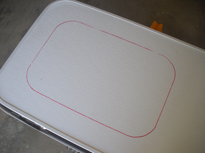

Step 2: using the interior trim ring for measurements, I made a cardboard template for the cutout. I'll be using a jigsaw to cut the opening, which cuts on the upstroke. To minimize possible chipping to the exterior door skin, the layout was made on the inside.

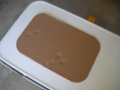

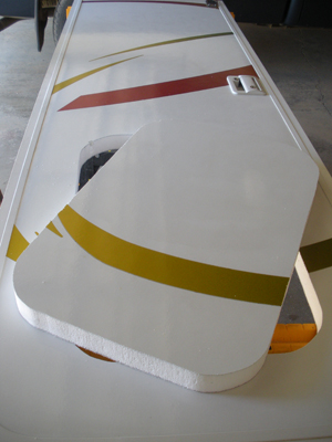

Step 3: drill a pilot hole for the saw blade somewhere INSIDE the layout line, take a deep breath, and cut away. This is what you'll end up with. There's  nothing inside the door but styrofoam so you don't have to worry about cutting through any interior structure.

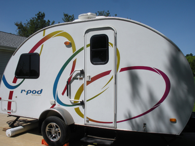

Step 4: the window comes with a pre-installed rubber gasket, so there's no need to mess around with that gooey butyl tape or nasty caulk. Just put the door in the opening, insert the trim ring from the other side, and drive in the provided self tapping screws. The pod with her new window:

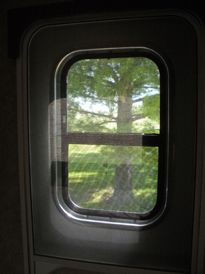

And a view from the inside with glorious light streaming through:
