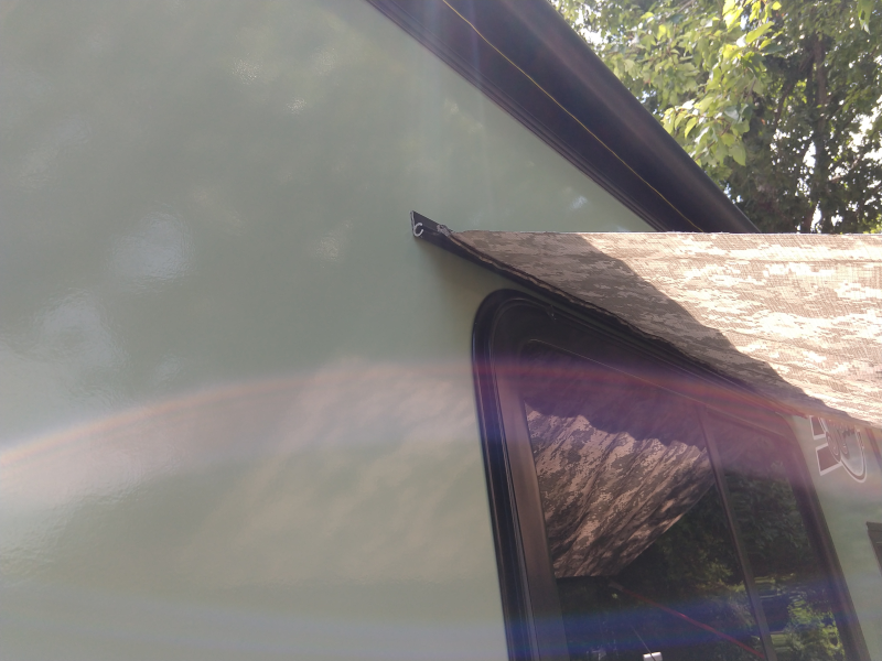

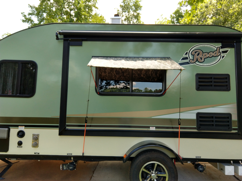

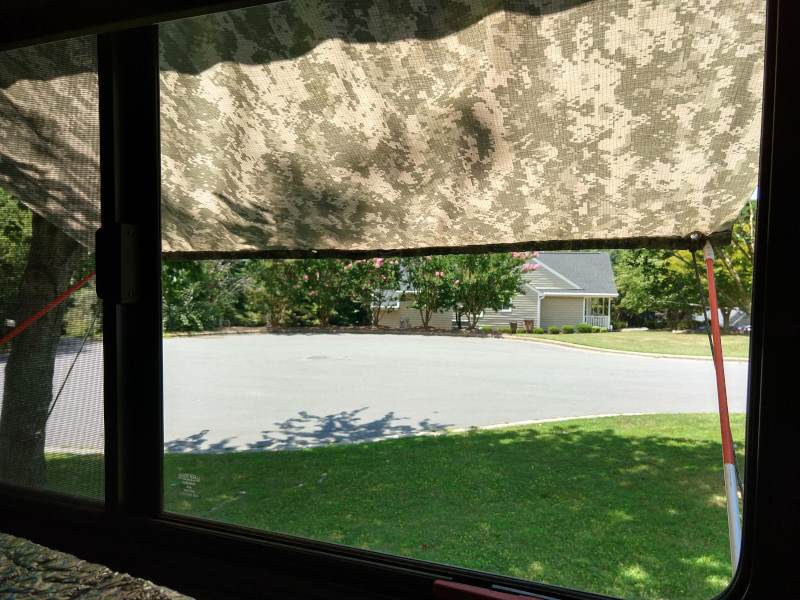

As I said above, I did not need the awning rail that came with the cover. What I have found lacking was a way to open a window when it is raining for ventilation. Since I now have the Thule awning, adding the door window helped, but that is only one small window. I wanted to do something to allow me to open other windows. This is the first one and, if successful, will probably lead to me adding similar awnings to the other windows.
I chose to add one to the dinette window. I cut a 4' length of the awning rail and used Lexel sealant and the screws that came with the rail to attach it just above the window. My homemade slide-out cover provided the material for the awning. I just cut a 4' length of the cover and added another grommet. I cut a driveway marker stake in half to act as support rods and cut a couple fo small lengths of PVC tubing. I used a heat gun to soften one end of these pieces and then flattened them. I am using another driveway marker stake to stiffen the outer edge, so I drilled a hole in each piece. I cut and sealed a slot in the edge and inserted the stake through the pocket and the tubing brackets. One end of the side supports goes there and the other end will eventually sit in a door protector once they arrive. For testing, they are simply resting on the dinette window frame. To hold the awning, I am using short sections of parachute cord and elastic bungee cords.
Here are some pictures:

Post Options Post Options   Quote fwunder Quote  Post ReplyReply Direct Link To This Post Posted: 26 Jul 2020 at 2:56pm
That's a nice addition, Stephen. It's great to be able to keep that window open in a rain and keep the sun out a bit.

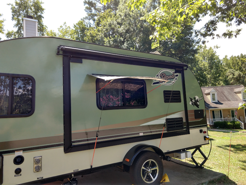

Okay, Dinette Awning 2.0. I did not quite like the looks of it and thought an additional length would provide better protection for when it rained. I lengthened the awning by a foot and now it now only looks better, it should perform better. Since the fabric is longer, I used a short length of copper tube to joint together two pieces of fiberglass driveway stake to strengthen the outside edge. I thought about removing the 4 foot length of keder rail and making that longer too, but I do't want to take the risk of messing up the fiberglass while removing the rail. Plus, I'm not sure the screw holes would line up exactly. The insert is stiff enough to hold the ends and the flex in the outside edge is now up instead of down. That should help it to shed rain better. Plus, the additional fabric should provide better shade as well.
I'm just waiting on Amazon to deliver the stops that will hold the rod ends that are currently resting on the window frame.
