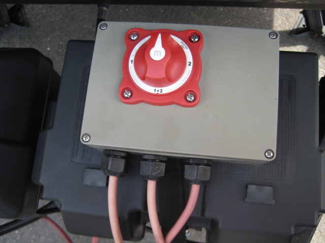

Hey toolman where did you put the marine switch. I have boats with them but they came that way.

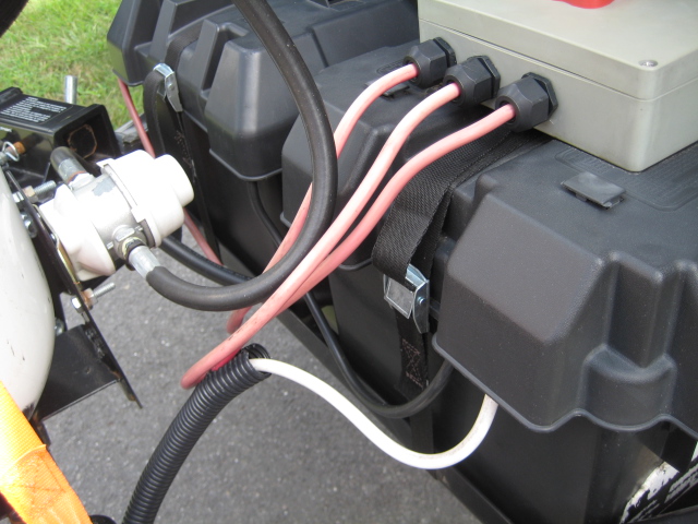

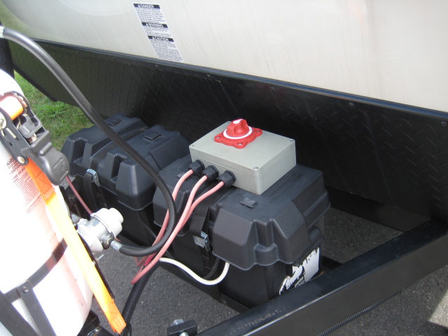

I mounted the switch inside a NEMA 4X fiberglass outdoor rated box (sealed lid), cable glands with outdoor rating UV rating, but I did drill 4 small hole sin the bottom, just in case water somehow got into the enclosure it can drain easily. The switch is IP67 marine rated, although this is the second one since 2012, the first imploded (broken internally and ceased to function).
 I made the custom battery cables. Basically, the switch has three connections. Each battery positive terminal  goes to a switch terminal (Battery 1 and Battery 2), the last switch terminal goes to the original camper positive.  The batteries (both) negative terminals are wired together to the original camper ground (white). I can use battery 1, or battery 2, or both in parallel, or both off.
