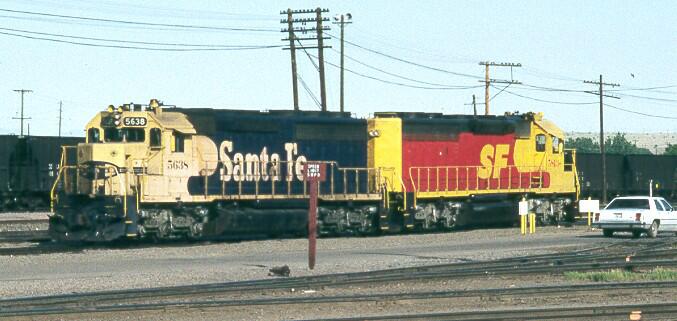

Yeah, putting out that 2.5 MW doesn't come cheap!  But, no worries about running the A/C.
So are you hitting a dead-man's switch all day for a living?

This would be my generator of choice.  For the neighborhood.  With the bonus that it could tow the pod, although only to limited locations.
How funny! I've got one just like this .. works purty good, too, 'cept it's kinda thirsty. Embarrassed

Direct Link To This Post Posted: 01 Dec 2014 at 3:39pm
But no sway/WDH required!
Direct Link To This Post Posted: 01 Dec 2014 at 3:22pm
