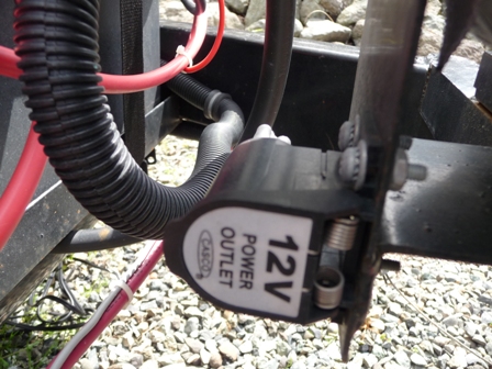

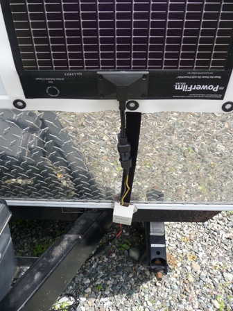

I use the 28 watt rollable solar panel from PowerFilm Solar.  It is flexible, weatherproof and lightweight.  I install it on whichever side of the rPod is facing the sun using suction cup hangers.  Here it is installed on the curved front of our 182G:

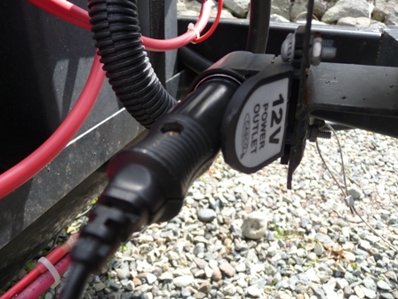

I have installed a 12v receptacle attached to the batteries on the front tongue, where I plug the solar panel into the rPod system.
Between the solar panel and the 12v outlet is a regulator which keeps the current flowing in the correct direction:
I have also installed a Volt Minder in the garage 12v outlet to monitor the voltage of my batteries.  In this photo it shows 13.39 volts from the solar panel in almost full sun:
The whole setup works like a champ when I am not connected to shore power.  The beauty of the PowerFilm panel is I can just lay it on the ground if it is too windy to stick to the rPod or if the rPod is in total shade.  Also, it works great if I just want to use it by itself to charge my tablet or cell phone.
