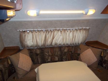

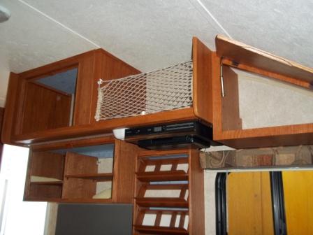

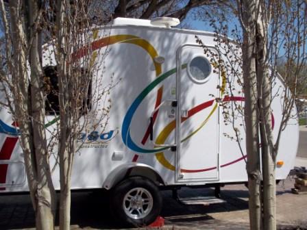

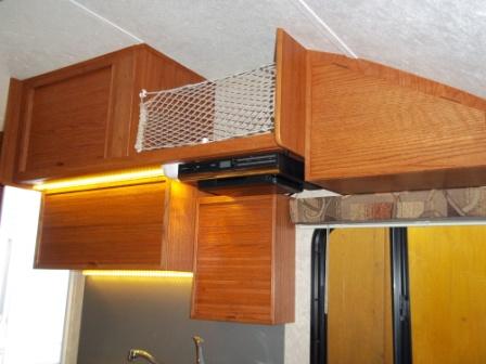

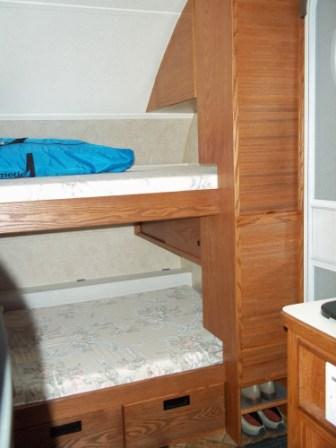

I am marwayne. I was asked if I would post some pics of my mods (renos) on our 2011 RP 172, so here are some of them.
  before
  after
 after
  before
  after
  after
  after
  before
  after
  before
  after
  after
  before
after
  after
  before
  after
  after
  before
  after
There are more pics on the rpod nation forum.

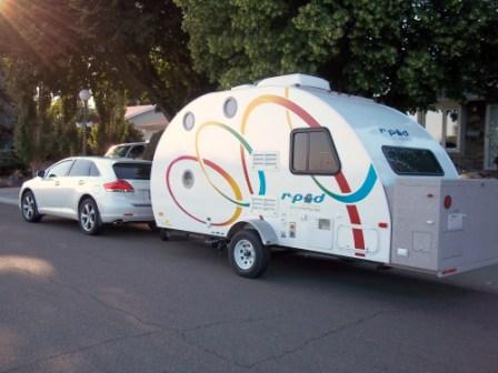

Direct Link To This Post Posted: 27 Oct 2011 at 2:50pm
How about some info on the boxes front/rear. Did you weld to the frame? What are you storing there?
Posts: 1004
Direct Link To This Post Posted: 28 Oct 2011 at 2:25am
The front box is made out of 1/2" birch plywood and boulted to the A frame,coverd with decking material.It holds propane bottle 2 batteries, small toolbox and rdome without poles.
Back box is made out of 1/2" birch plywood,coverd with decking materiel. I exstanded the outer rails and the sparetire hitch, boulted box to the exst. Then I fitted a spacer between the trailer and the box and boulted them together. In the box are 2000 watt honda gen. inv. 81/2' inflateble boat, webber BB, 2 horse honda outboard motor, 5# propane bottle, 2-5 litre containers of gas and a few other little things.
