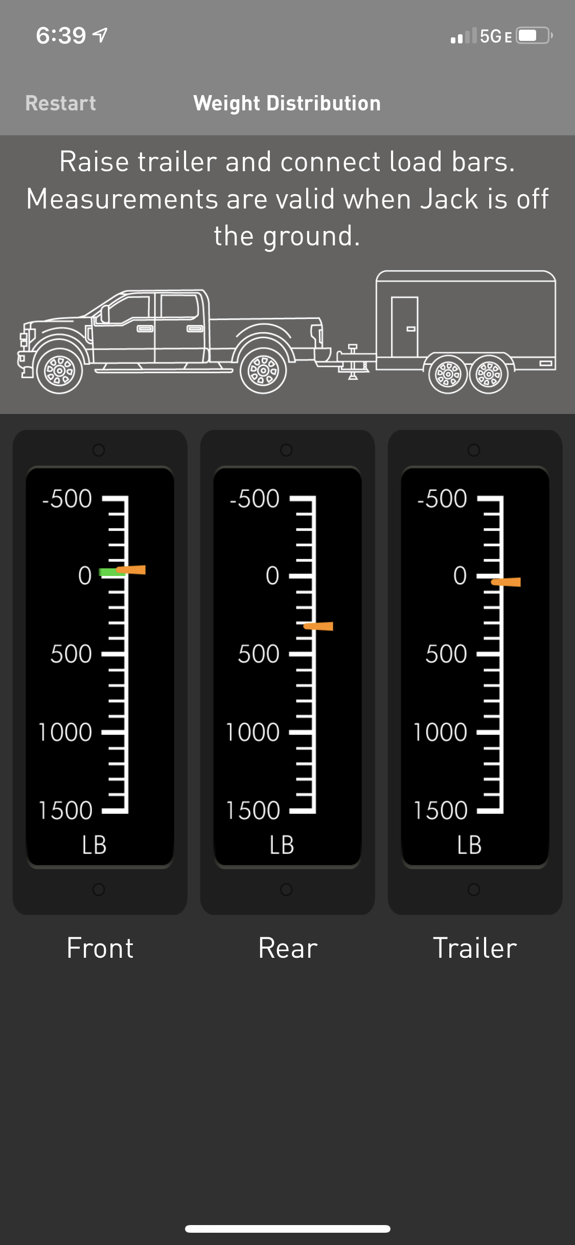

On the subject of the BetterWeigh tool, let me clarify a bit. I've not done as detailed of an analysis as I'd like. Not yet anyway. But I've seen enough to feel confident that it has at least some value. Moreover, i'd argue that the value already matches it's $100 price tag (I evaluated it and planned to return it if it wasn't living up to my expectations.
So far, I've done a fairly accurate tongue weight check against a credible tongue weight scale, and I've done a "cargo" weight check inside the vehicle where I knew the exact weight of the cargo. In both cases, the weight was within ±50 lbs. (cargo was within ±20.) I did learn that it's best to let it settle (the measurement is refined as it gets more measurements to generate an average,) and it's best to take a few measurements (there's usually at least one outlier from some unexpected force.)
And I've discovered it to be quite sensitive even to the slightest pressure, which is why settling time and multiple measurements help (and turning off the vehicle for many measurements.) My initial test was on level ground in a large church parking lot on a windy day. But I couldn't get consistent measurements because the wind was moving the tow vehicle enough to severely impact the measurements. It's important to note that many of the measurements work on a calibrated model of suspension travel for the tow vehicle, measured through the tow vehicles change in angle (read by the accelerometer,) due to additional weight added to the vehicle. So wind gusts that gently move the tow vehicle are interpreted as angle changes and can, depending on how soft or firm the suspension is, equate to significant changes in measured weight.
Here are some example measurements I took.
This is a measure of "cargo" weight after calibrating suspension travel. The "cargo" is myself, and I weighted 161 lbs. on the bathroom scale just before I stepped into the third row of my minivan to take this.
This is a pair tongue weight measurements done in succession. My Sherline tongue weight scale was measuring ~300 lbs. at the same time (the scale is purposefully hard to get precise measurements with, so it's hard to be certain.) NOTE: This was the best out of about 5 tests I did, and it was in that windy parking lot. But they were all between about 270 lbs and 340 lbs., with one outlier at almost 390 lbs. Note that my WDH weighs about 85 lbs. and the RP-171 dry tongue weight is specified at 250 lbs., but I never confirmed what its actual dry weight was without my hitch, so I don't have an accurate measure for my specific unit. Still, this all feels "in the ballpark" enough to build some confidence in the device.
After the tongue weight test, I tried out the WDH tuning feature and again, it got pretty close. Note that this was taken a day after purchasing the trailer where the dealer installed and set up the WDH. Judging from a tape measure test, the WDH seemed well set up, and this just seemed to confirm it.
Finally, I don't have any screenshots of the combined vehicle weight measurements that it's capable of because it requires you to accelerate at medium throttle to 15 mph on level ground. I never thought to get a screenshot once I'd slowed down to look at the result. Interestingly, the reason for a maximum 15 mph speed is to ensure you don't shift gears. The tool needs to eliminate any variable gear ratios and there are few to no automatic vehicles on the market that'll shift out of 1st under 15mph when you've got at least half throttle.
In any case, I performed a measurement on my tow vehicle with just me inside and no real cargo and got a little under 5000 lbs. which is about right for our 8 passenger minivan. Later, with a few more humans in the car, I hooked up the trailer (dry) and did the same test. I got a bit under 8000 lbs. (maybe 7800-8000 lbs. or so) which, assuming a 2500 lbs. dry weight (as stated on my sticker from Forest River,) and the addition of the almost 100 lbs. hitch and extra humans again, seems about right.
I didn't get to do more then one measurement for combined weight (one for the tow vehicle, and one for both.) And I really want to because I think a few more measurements would give me a lot more confidence if the numbers converged. And I haven't had a chance to put it on a scale before I do this test.
But again, this isn't a perfect evaluation, but it's enough to make me listen to the numbers it's giving, and given how darn simple and easy it is, made me feel like it was worth it's $100 price tag.

I might be misinterpreting your setup when you're getting your tongue weight, if so sorry in advance. But if you're doing it with the wdh tensioned that's not correct. TV tongue weight capacity is not increased by adding a wdh, unless the TV mfg explicitly states that. That is because as soon as you go over any kind of high spot in the road the full tongue weight of the trailer is right back on your TV. Just the way wdh's work.
From what you're saying I'd highly suggest that you still take your rig through a public scale once when loaded as you plan to travel, including cargo, gear, fuel, and humans. That will help you get your software calibrated if nothing else.
Posted By: Edward_Larkin
Date Posted: 14 Aug 2020 at 9:38pm
Sorry, I wasn't explicit in my description. Tongue weight was measured without the WDH engaged (bars disconnected,) but still attached so that the full weight of the hitch (with disconnected load bars) would sit on the rear of the TV as dead weight added to the tongue.
In fact, the BetterWeight is pretty explicit about these things. For tongue weight, it doesn't assume a WDH (though I included it in my measurements because that matches my plan of travel.) But for the WDH test, the tool is good enough to explicitly have you take a reading with the hitch disconnected to get trim of TV without any trailer or hitch, then with the WDH on, but without the load bars attached, to get an accurate tongue weight measurement with hitch and figure out how far out of "normal" you are, and then it gives you target settings for front and rear TV axle weight (in green on my screenshot,) to get the TV back to "normal" trim through distribution of weight. It then instructs you to attach the load bars to the trailer and tension the rig.
In essence, in this last state with green targets on the scales (which is where I took the screenshot) you're supposed to tension the rig (tongue jack off the ground,) check if you're "in the green" and if not, unload the rig (put the tongue jack back on the ground and de-tension the bars) and make an adjustment. Rinse and repeat until all the scales are in the green.
Note that it assumes the vehicle doesn't move during any of this (drive to a new location.) If you move at all, it's all invalid. It also assumes you're on relatively level ground, and recommends the engine be off to prevent any wiggle. It defines "level" as any place you can put your TV (and trailer) put the TV in neutral, disengage all brakes, and the rig doesn't move.
But, despite all that, I still agree with you. I fully intend to take it through a scale with my planned loads, if for no other reason then to complete the evaluation of the tool and prove to myself it's value completely. It's on the todo list (along with about 50 other things.)

Sounds good and I'm interested in hearing how accurate the software is in determining GCVW.
As for "level" I'm having trouble understanding how the tool can determine whether the wdh is tensioned properly unless the rig is on a dead level surface. As soon as the TV rear axle is either higher or lower than the front and trailer axles the tension level and axle loads are going to be thrown off.
It doesn't take much out of level to throw it off. The one time I weighed with my wdh tensioned I saw about a 100 lb difference in axle loads between entering the scale  (TV axles on the scale and the trailer off) vs exiting (TV axles off the scale and the trailer on). And the scale was only at most maybe 1/2 inch lower than the pavement at either end.
That being said I think it doesn't really matter what either the Betterweight or scales say your wdh effect is.  The real world wdh effect is going to vary from zero to probably about 2x whatever you adjust it to depending on the flatness of the road.  If you set up the wdh on level ground per instructions  so that the front suspension height is back where it was without the trailer you'll be fine.
Agreed. And it's specific about being on a level surface (where a vehicle and trailer in neutral won't roll.) Finding a flat parking lot is essential. Luckily, I live in a pretty flat place. My driveway has just a little bit of a slope, but I've got a few big parking lots nearby that fit the bill just fine. I'll add that, for this specific test, the device might not need a truly "level" surface (as in, no roll,) but the grade must be even across all three axles, which is how you can ensure your WDH is not artificially loaded or unloaded by variation in grade between axles. Still, if your TV was on level ground, but your trailer was, for example, on a grade, putting the TV in neutral would cause it to roll, so the test method of no roll in neutral is sound for both getting true level, and getting zero grade change.
Originally posted by offgrid
That being said I think it doesn't really matter what either the Betterweight or scales say your WDH effect is.  The real world wdh effect is going to vary from zero to probably about 2x whatever you adjust it to depending on the flatness of the road.  If you set up the WDH on level ground per instructions  so that the front suspension height is back where it was without the trailer you'll be fine.
Also couldn't agree more. The real world is dynamic and the pressure of the WDH will vary wildly going down the road. But, that doesn't change the fact that, as a starting point at least, setting it up on level ground to restore unladen TV trim is best. And the BetterWeigh does a fine job at that. Admittedly, a tape measure looking at the height of your wheel wells works just as good, and costs way less. So, I wouldn't buy this just for the WDH capability. But it's a nice touch.
I agree that if the device is measuring the difference in TV axle heights with and without the wdh tensioned then the rig really wouldn't need to be dead flat, but it would need to be on a planar surface. I was surprised how much difference in axle load a very small height change in the surface made, so I do have my doubts that "not rolling" alone would be good enough.
You can get the front axle back to its unloaded condition with a wdh but not the TV rear axle, which will inevitably have more load on it with the trailer attached. The tongue weight has to go somewhere. So some TV squat is fine and expected.
You might want to put your numbers in this calculator and try adjusting the assumed wdh tension, I found it helpful to understand what was going on. If you reduce the trailer weight to say 1 lb you can also see what the TV would be by itself.
