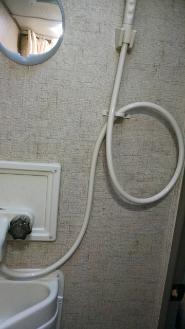

Part of the problem with the sink is water running down and/or splashing off of the shower hose. I just unscrewed the hose under the faucet to help at least that part of the problem. Still need to secure the now-dangling shower hose in a way that will still allow easy reattaching it for the few occasions  when we will use the shower. Now need to figure out some type of "guard" to keep water from splashing over side of the sink.

Direct Link To This Post Posted: 12 Jun 2016 at 9:16am
Reattach with the hose's curve headed toward the side where the shower head is. Then pull the excess hose through the loop on the wall so that the excess is on the side where the shower head is. That will hold the hose away from the water stream sufficiently to eliminate splashing off the hose. I'll try to get a picture. When I do, I'll edit this post and add it.
Edit: Here's a picture.
