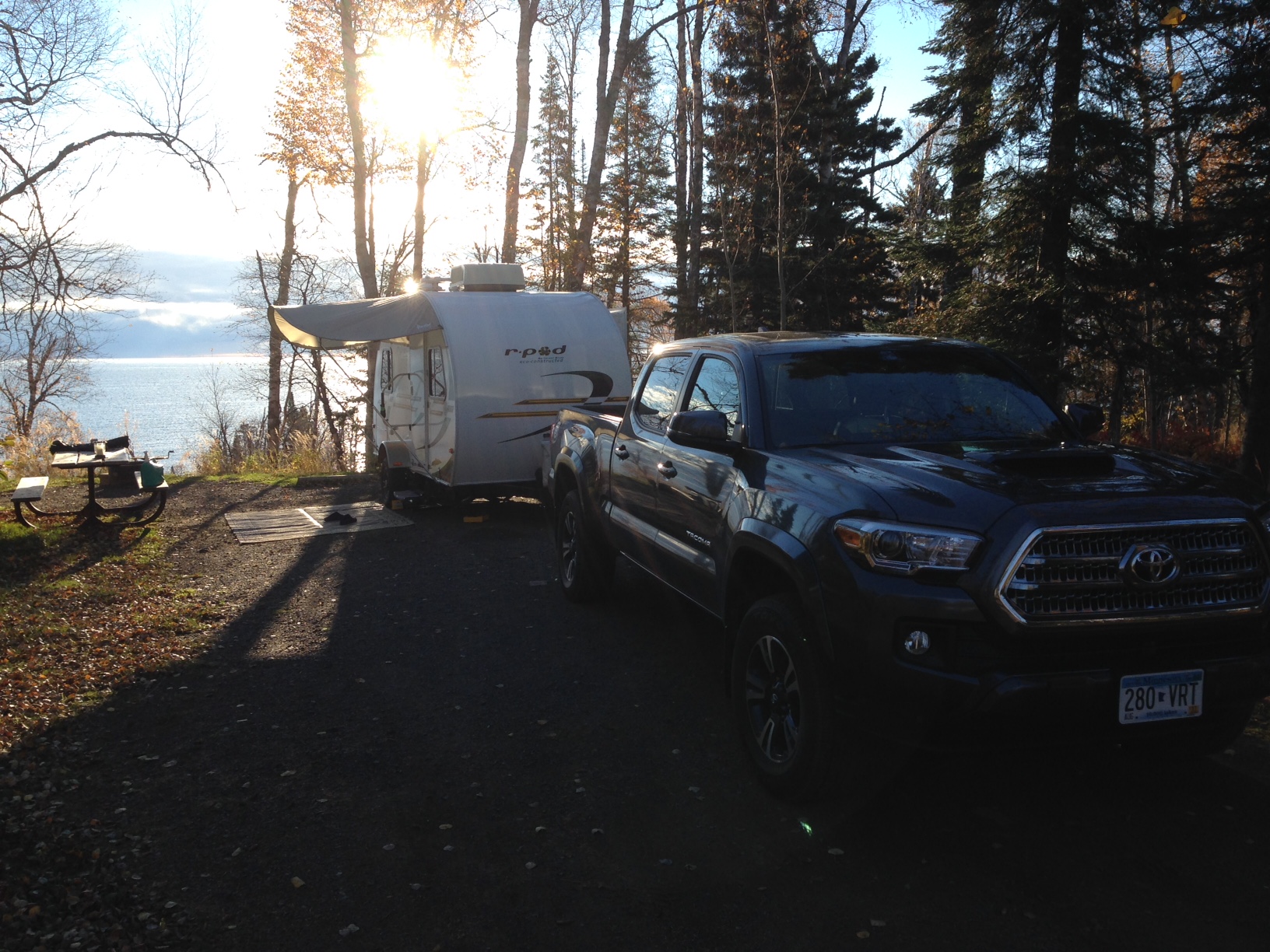

Posted: 22 Dec 2016 at 12:52pm |
Excellent picture!!

We got a 2017 Tacoma this fall with tow package. We had a Honda Pilot, this is a big improvement for towing. We tow in 4th gear most of the time - get 12MPG or so. You still know the POD is back there, especially if it is windy, but I am happy with my choice. We live in Northern MN, icy, snowy roads are the norm all winter. I am impressed with the 2WD, and I have not felt the need to put any weight in the bed, the tires feel good, the traction control system works well in 2WD. Pop it into 4WD and it holds the road really nice, yes on dry pavement with tight turning you do not want to be in 4WD - but why would you anyway?
