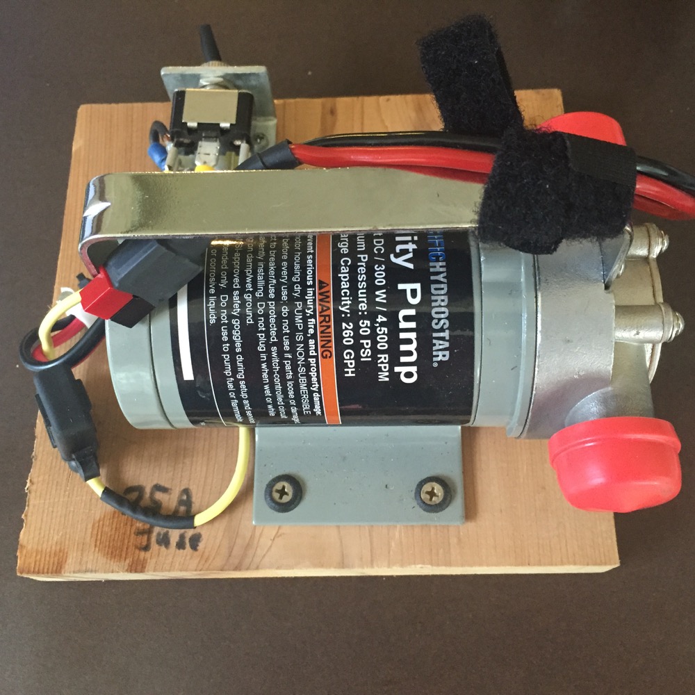

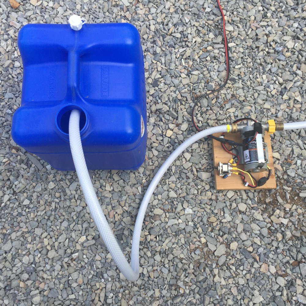

I use a 12v. external pump (300watt/260gph water transfer pump) and two 7 Gallon Aqua-Tainer Jugs for toting fresh water. Those I just leave in the back of my TV and pump into FW tank. Two trips fills tank.

Fred, did you really mean 300watt? 25Amps @ 12V? That ought to pump 260 gallons per minute!
Direct Link To This Post Posted: 13 Sep 2016 at 9:58am

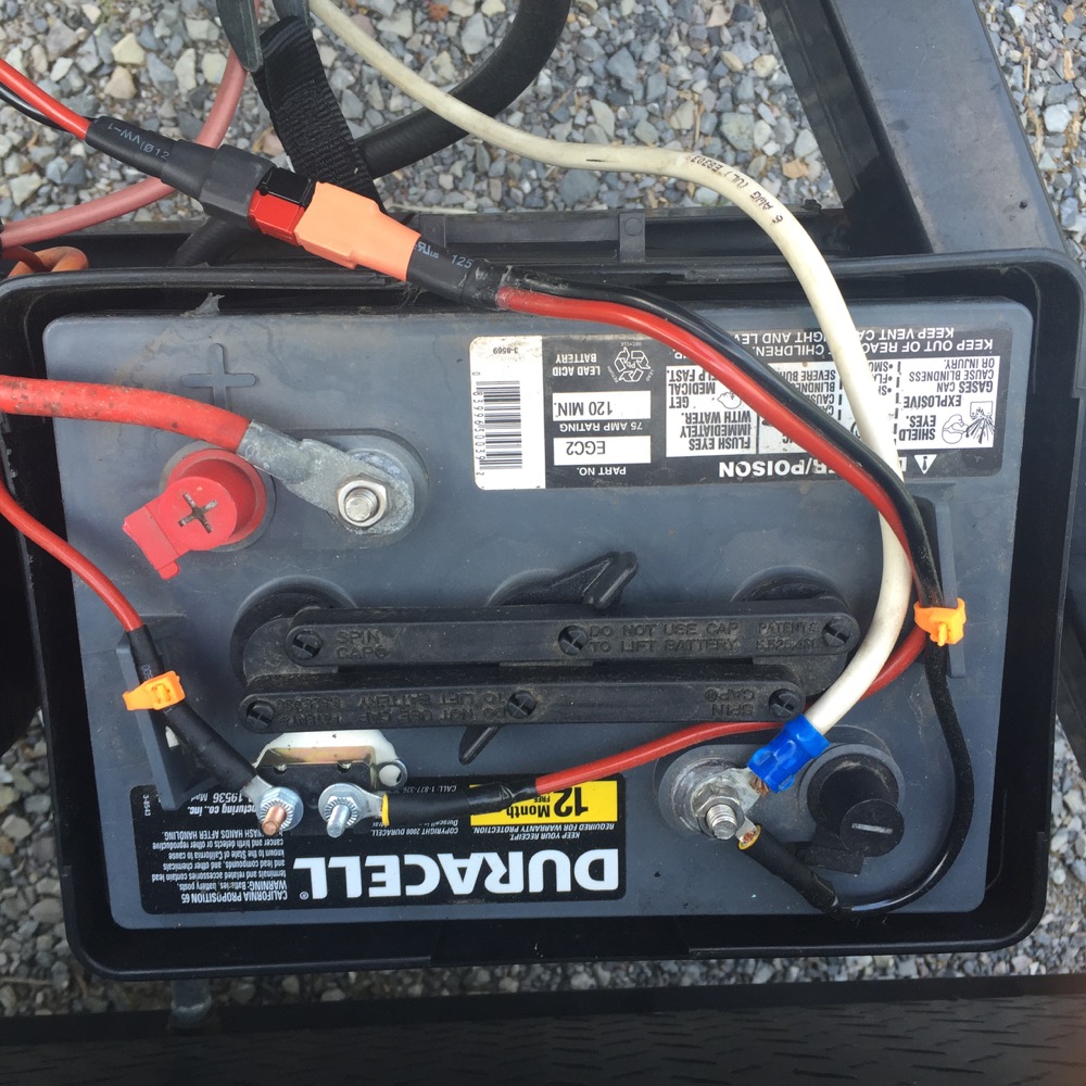

I did Charlie. Takes less than a minute to pump 7 gallons into tank. I carry two jugs. I use a six foot 10 AWG extension (Anderson PowerPoles) to battery - 40 amp Bussmann Breaker attached to battery. I have another short extension that allows me to leave water jugs in TV and pump right from there although that may be pushing it for current.
I glued the Bussman Breaker to Battery with 3M 5200.

Looks like a real fire hose or a heck of an outside shower Big smile
Direct Link To This Post Posted: 13 Sep 2016 at 12:33pm
My 40 ft. class A campground neighbors just couldn't figure why their 100 gal FW tank emptied so fast! Tongue
