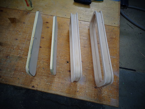

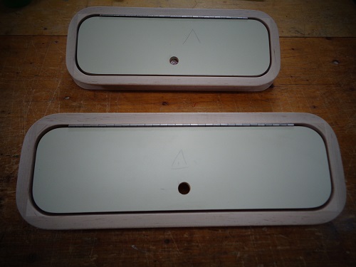

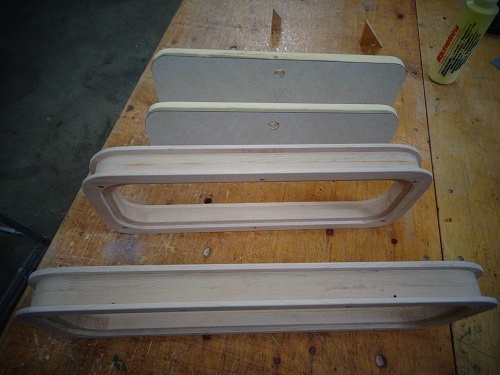

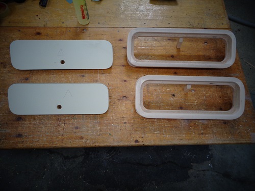

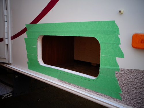

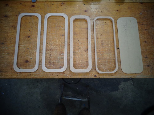

Posts: 1004
Direct Link To This Post Posted: 02 Aug 2016 at 4:26pm
No I didn't use the cut out, I put one on each side. The frames and doors are home made, 800$ for 2 little hatches to much to my liking.

Marwayne, Very impressive work.  Are the frames out of wood?
Pod: 2013 178
TV: 2014 Explorer Limited with tow package
Posts: 1004
Direct Link To This Post Posted: 03 Aug 2016 at 1:06am
Yes they are, three coats of liquid rubber and than spray painted.
