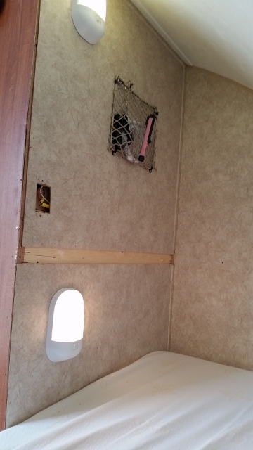

The prior owner of our 2010 176 removed 1/2 of the top bunk in the front. I was happy with this mod and the storage it provided, but I still felt like a sardine in a can when in bed. So after 3 years I decided to to remove the rest of the upper bed and replace with "Lowes" shelving. When I removed the base of the top bunk I was pleased that the screw holes in the front and side walls were easily repaired with colored caulk/filler. However, the wall behind the entertainment center was a different story. The finished wall did not cover the entire space.
I covered this spot with a 1/2"x3" trim board that I stained (Minwax Gunstock) and varnished. To provide a little more support I continued this around the side wall. I bought a 48" shelf, cutting the shelf to 30 1/2 inches to fit the width of the space. I mounted the remaining piece about 16 1/2" above the first shelf. I had removed the lower net storage previously because of the 8" height of my memory foam mattress, but the upper one was in the way of the upper shelf. At this point I removed the upper net storage and moved it lower - again filling the holes with colored caulk. The end result provides just a little less storage than before, but leaves the area much more open and airy.
