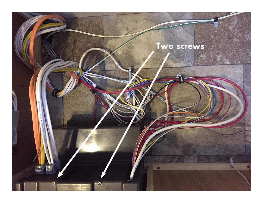

Having trouble taking the back cover off the electrical junction box to get to an empty 12v slot so I can install the hot wire for the plug. Taken the seat off and plywood cover (see photo) but the box almost seams sealed. There are only two screws on top which does not loosen the box. The photo is looking straight down onto the floor. Does the front panel snap off somehow and reveal screws? Did not want to break anything. What I'm I missing? Thanks,

The power panel comes out from the front. several screws hold it in.

Couldn't see the screws in the front as they were covered with white sticker description labels. Pulled the stickers aside and the screws were right there.
