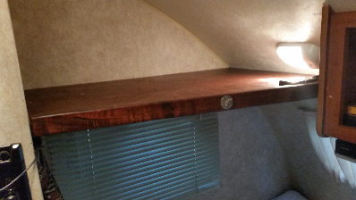

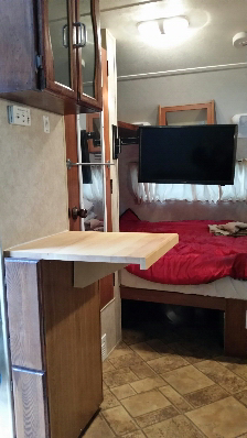

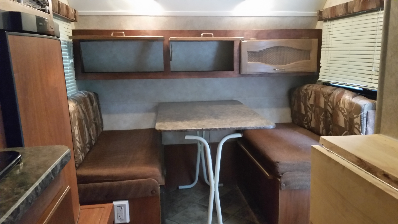

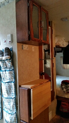

Some images of my interior modifications.20150909_093830.png20150909_093055_2.jpg20150913_171827.png20150913_171338.png20150913_171827.png20150909_093055_2.jpg20150909_093830.png

Are those forward 3 cabinets stock or added?

No the forward cabinets are not stock. I made them. They added a tremendous amount of storage space and convenient access. Material cost was $100. The doors I salvaged from an old mo tor home.

Nice curved wall cabinets! Want to make some more? Seriously.....I think you might sell quite a few of them. Me first!

Very impressive. I'm curious on how you attached the cabinets above the dining table to the wall. How deep were they? Safe Travels.

Will post some more detailed pictures and dimensions soon.

The cabinets and the shelf looks great. I just acquired a r-pod 171 and want to add shelf over the bed. How did you attach the shelf to the wall?

I screwed the shelf to side of bathroom wall. It is also supported by valance above the window. The shelf is also screwed to the little overhead cabinet that houses the entertainment system.
